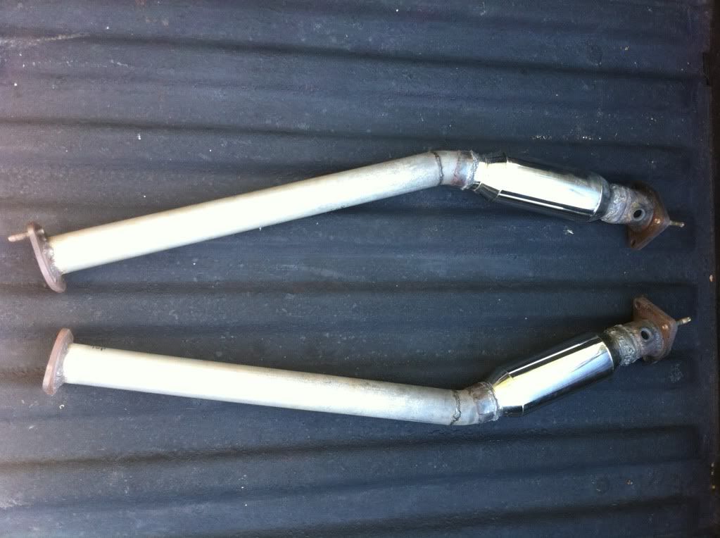

I just changed my exhaust AGAIN. Since I made catless testpipes early this year I have been rewarded with a little too much volume, rasp, & rattling. These test pipes were "fake cats" with a straight through pipe inserted inside.

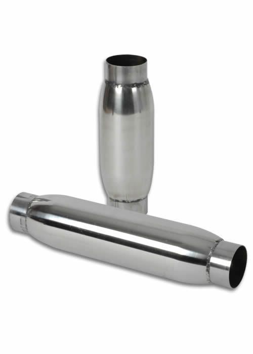

So I just got a pair of Vibrant resonators. These are little bitty 3.5" x 10"(body) bullet resonators made of polished stainless steel. I think they are 12" overall. Mine have a 2.25" in/outlet. Cost me $47 each. Anyway got them put in today. Put them where my primary (and fake) cats were.
I was pleasantly surprised they did an excellent job. They cut sound levels maybe 15-20%, took a little rasp out, and took the rattly noise I had after I made the "fake cats" earlier this year. I'm very pleased. My truck is still pretty loud, but I can hear my intake much easier, which I love. And I don't have to worry about "unwanted" attention now. I'm pretty sure this is my final exhaust setup now. Really.
Here is couple images. Please ignore all the welds-I've had to rework those testpipes about 3 times in the past to finally finish with this setup now.

Oh the other thing I forgot to mention is these are a straight thru design and no louvers or restrictions of any type. Basically these tone the exhaust down just like when I still had my primary cats, but without their restriction.

I had fake cats before I installed these resonators. Those fake cats were custom made by myself. But the were a bit rattly and my truck was louder than I prefer, thus the reason for going with my resonators instead. And even though these are straight through design, they still have perforated tubing surrounded with sound deadening material.

Pretty much. I had a good chance to drive it a lot this weekend and I am still very pleased. My tone is pretty deep now with very little rasp. I think their position so close to the headers make them even more effective.
Here is what they look like inside---
