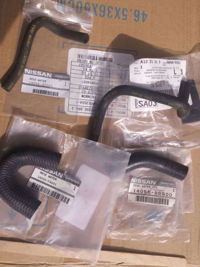

I'm about to start wrenching on my KA24DE to repair a small coolant leak under the intake manifold.
In the pic are the 4 new hoses that I'm going to install and I also have a new intake manifold gasket.
Anyone know if there are any other parts that I'll be needing to complete this repair?

I think you're most likely OK with what you have. You'll know once you get some stuff off and have more access/visibility.
The only coolant leaks I've experienced first-hand on my two KA24DE 2.4l Frontiers have been water pumps on both 1998 and 2004, and a bad radiator gasket on my 1998. So I haven't replaced the bypass hoses on either of mine.

Well the the leak was coming from the "U" shaped hose. I replaced the four hoses that are pictured in my original post. And did so without removing the intake manifold.
Unbolting the power steering pump and removing the mounting bracket and plate allowed just enough access to swap the bypass hoses.
Unfortunately, the heater inlet hose replacement will have to wait until it becomes a necessity. It connects to the back side of the engine block and it seems that the intake has to be removed to access. I tried getting to it from underneath but space was too tight.

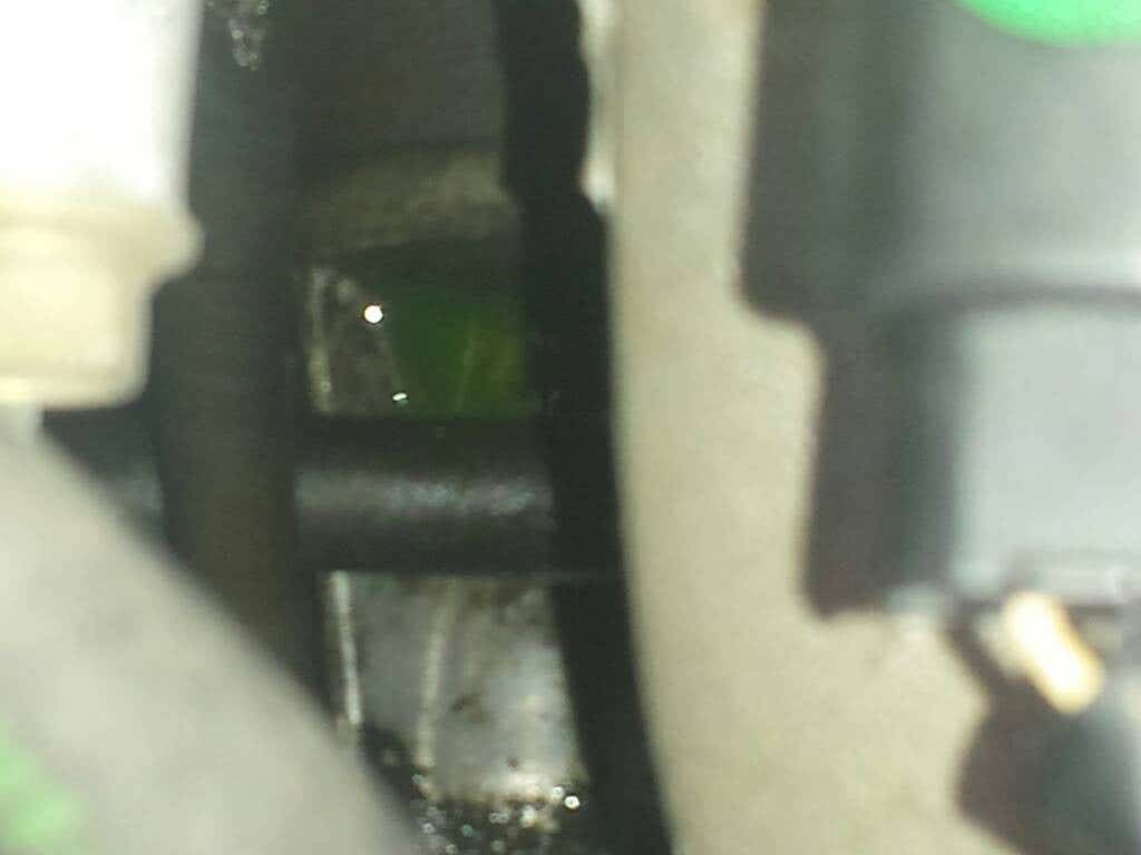

This picture shows the heater hose which is attached to the rear lower engine block with the arrow pointing to it. If I remove the flat bracket next to the EGR (pictured) it will give me room to reach the heater hose, but the small bracket (or whatever it is) which I circled in yellow is in the way. Does anyone know what this part is or how it may be removed?

Is the small bracket preventing you from removing the air cleaner support bracket (the egr doesn't have a bracket)?
I couldn't find anything definitive looking at the exploded parts diagrams. Was thinking maybe this cable mounting bracket, which doesn't look the same I know.. But I haven't checked where the shift cable actually runs.
I'm going to reach a mirror in there to hopefully have a better look.

Sorry Butterman....I'm at a loss...I replaced my heater hoses many years ago on my '95 240SX, (KA24DE motor), but can't recall if I ever changed the heater hoses on my '04 Frontier. From what I can recall, I used a ratchet extension or two and those universal swiveling sockets.... It seemed like a pretty easy repair to me... I tend to remember those repair jobs from hell... Sorry Buddy....🤷‍♂️🤷‍♂️🤷‍♂️
