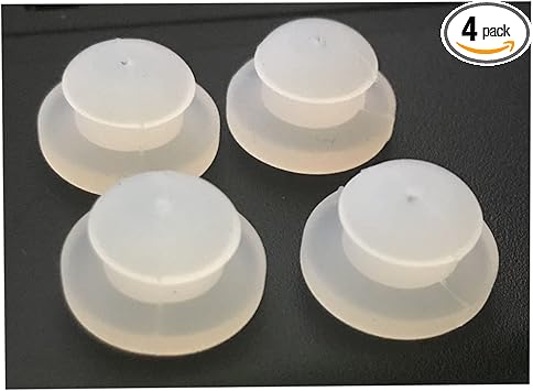

Brake pedal/clutch pedal plastic stop plug part number 46584-5P010 or
Dorman Accelerator Pedal Stop Pad 74015 Most folks epoxy or JB Weld in a dime to press plunger on the stoplight switch or a dime if one is a big spender.
4PCS Brake Pedal Stop Pad Compatible with Nissan Infiniti 46584-S0100 46584S0100
