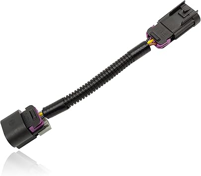

I'm Working On It. Just need a little more time. It will work with the eliminator. I have a few screen shots of the schematics and figured out which wires do what. The A.S.S Switch is an 8 Pin Setup and so is My A.S.S. Eliminator for the Nissan 2017 Xtrail. All it does is it gets plugged inline in the wiring and connects to the A.S.S. Switch but has a power cable that's a constant hot with a memory chip in it that remembers the last selection (ON or OFF).
That Shop Manual Shows the Switch to be 8 Pins and so is my Eliminator
From The Shop Manual It Shows Me The A.S.S. Switch is 8 Pins, Tells Me What Color They Are, What Their Function Is, And Where They Route To. Its Totally Doable. Only Benefit I See Is That I Don't Have the A.S.S. Symbol Blinking on The Cluster Which IMO Is No Big Deal At All Really. ISS is short for IDLE START STOP
I have a few more schematics that explain things in more detail but you should get the basics by now.
What i'd really like to do is delete that A.S.S. Switch and put in the '22 - early '23 Piece. They're the same except the '23 has the added A.S.S. Switch and the '22 has just the hazard and passenger airbag. The Hazards are the same size but what they did was make the passenger airbag light half the size and make the A.S.S. switch the same size and put them on the either side of the hazard for symmetry. I'd be willing to bet the full and half sized passenger airbag light have the same connector in the back. In fact all i have to do is look at the manual to see. So basically just pop out the no longer needed A.S.S. and put in a '22 Passenger Airbag light and done. If not, then you may need the bezel part from a '22 that the switches go in as well. Really its no big deal to make it happen on the cheap.

ELIMINATOR - work in progress!!!
This A.S.S. Eliminator that i bought on Amazon for a Nissan XTrail which is from my understanding the foreign version of the Rogue. I Pulled the thing apart to look at it and took all the Fabric Electrical tape off. I looked at the way it was wired up to see if it was wired to make a connection with PIN 5 and PIN 7 and IT WAS and IS. I pulled a couple of pieces off the dash to get to that A.S.S. switch for the moment of truth today to see if it would plug up in line and if the connections were the same to work with the 3rd Gen Frontier. I was super excited when it plug up PERFECTLY but no dice. No Idea why its not working
Plugged Up Perfectly IN LINE with A.S.S.

ELIMINATOR - NOW WORKING
If you've been following this thread you'll know this is Option #3. For me it really is a Toss Up between #2 and #3. With #2 the A.S.S. is ALWAYS off and with #3 you have the option to turn A.S.S. On or Off. Option #1 and #2 are both Free and #3 costs about $40
Anyways, THIS IS THE ELIMINATOR YOU WANT - They May As Well Put "Works With 3rd Gen Frontier" In The Title Now
I made a mistake on the first attempt with the Eliminator. The 1st 2 Methods work just like i said - BUT the Auto Start Stop Eliminator ALSO WORKS! I had it hooked up to a constant hot at the fuse panel. It needs to be hooked up to switched power. Once i hooked it up to the "Dealer OPT (ACC)" The Eliminator started working just as its supposed to. After 3 Seconds the switch pulse gets sent and turns On the switch, A.S.S. is turned Off, and the orange light shines. This Eliminator remembers your last selection as well. So,if you kill the truck with A.S.S. ON - the next time you start it will be ON and no orange light. So anyways, IT WORKS!!!. The box it came in also had an orange plastic panel puller to help you take the dash pieces out which takes just a couple minutes.
Anyways, It's truly Plug & Play. The Connections are a perfect fit and its wired up perfectly. You'll just have to route and probably extend your power wire a little. Mine was too short.
I just purchased another new Un Molested Eliminator. I'll save this current one thats been half way dismantled for a back up
EDIT: see next post about changing the fuse size for the eliminator

The Eliminator has 2 Fuse slots. 1 for the fuse you've pulled and plugged the eliminator into and another for the actual Auto Start Stop Switch. The Eliminator came with a single 10 amp fuse i'm guessing is for the Eliminator. This is insanely high as that switch in low voltage and runs directly to the Computer. I went and bought 2 amp mini fuse from O'reilly's. The eliminator takes Low Profile fuses but the mini fuse worked fine. 2 Amps is more than enough. If they made a .5 or 1 Amp fuse i would've put that in there instead but 2 is as low as these fuses go that i'm aware of.
Bought an assortment pack of Low Profile Fuses on Amazon for 5 bucks. This new frontier is the first time i've seen them. I have a whole sandwich ziplock full of the Micro Fuses i picked up from the junkyard but have none of the Low Profile:

Auto start/stop is so frustrating. On my newly purchased used 2021 Chevy Traverse, eliminating it was as simple as plugging a $15 hood switch bypass harness in between the hood switch and the switch harness cable. No codes that I can see with my reader and the hood open message still works. No more auto stop/start.
I then tried one on my daughter's 2016 8th gen Malibu and it doesn't work. It indeed eliminates stop/start, but it immediately lit the MIL with a hood switch circuit range code. No go as it's due for yearly state inspection and you won't pass with the MIL on.
#31 ·
All you need to do is identify which 2 wires make a connection when the switch is pushed and put a jumper wire in between them so they have constant connection. WHen the car is started the switch will automatically turn on as if you pushed the switch but you don't have to push the switch because the connection thats made when the switch is pushed is already made. That's all a switch does is bridge 2 connections to make 1 so that power can flow.
Or just buy the eliminator on Amazon for 15 Bucks. SIMPLE
