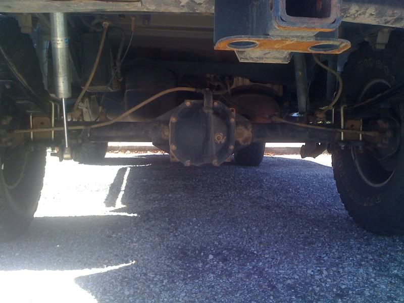

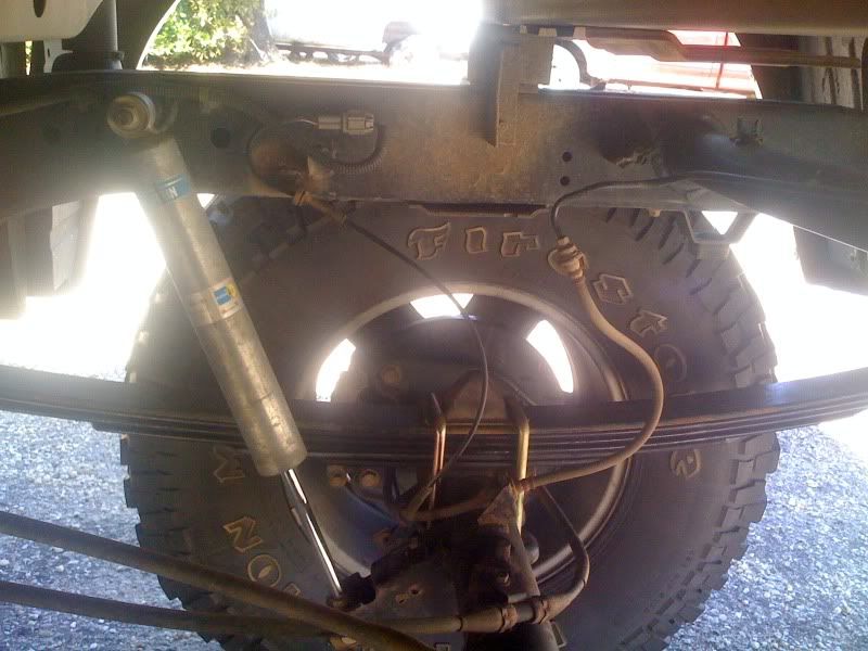

Well i had a few hours yesterday to play, so i took my leaf springs out and redid them with xterra leafs and an AAL. the only thing i kept from my leaf pack was the main frontier spring. they have alot more arch. sorry my phone captured a bunch of light

Nice! I believe they have more arch because the Xterra is axle over leaf. How is axle wrap? The ride is probably no different.

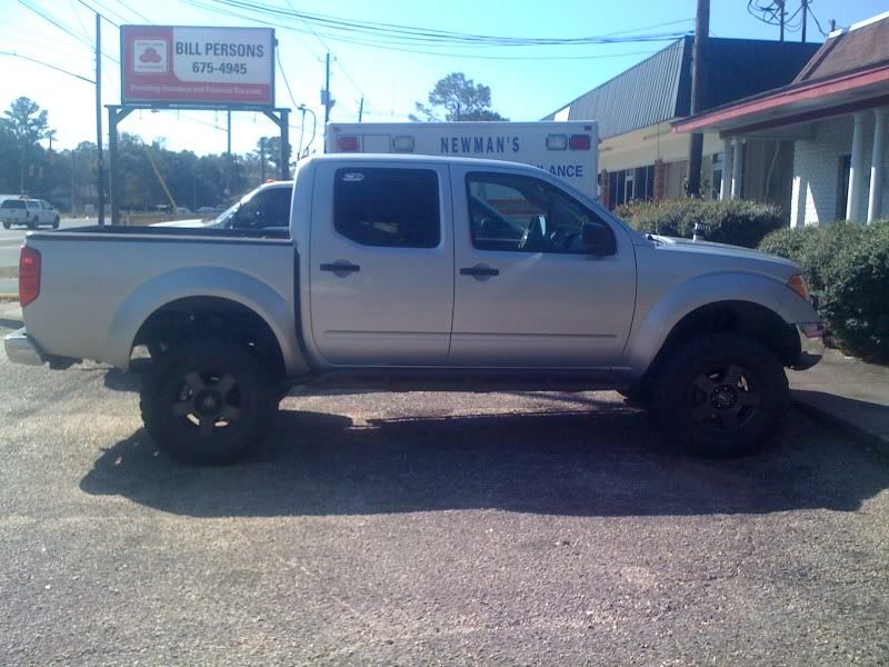

How much lift did you get?

How is axle wrap?
Doesn't this only become a 'real' issue when you start adding block spacers? I don't see any blocks.

it gave me about 2-3 more inches than my single AAL i orginally had. i dont feel any axle wrap, im not really worried about that. the springs are kinda bouncy but not to big of a deal.

yeah theyre siting in the garage, some 35" firestone destination m/ts. im thinking about adding another leaf front my frontier pack and gaining a lil bit more.
