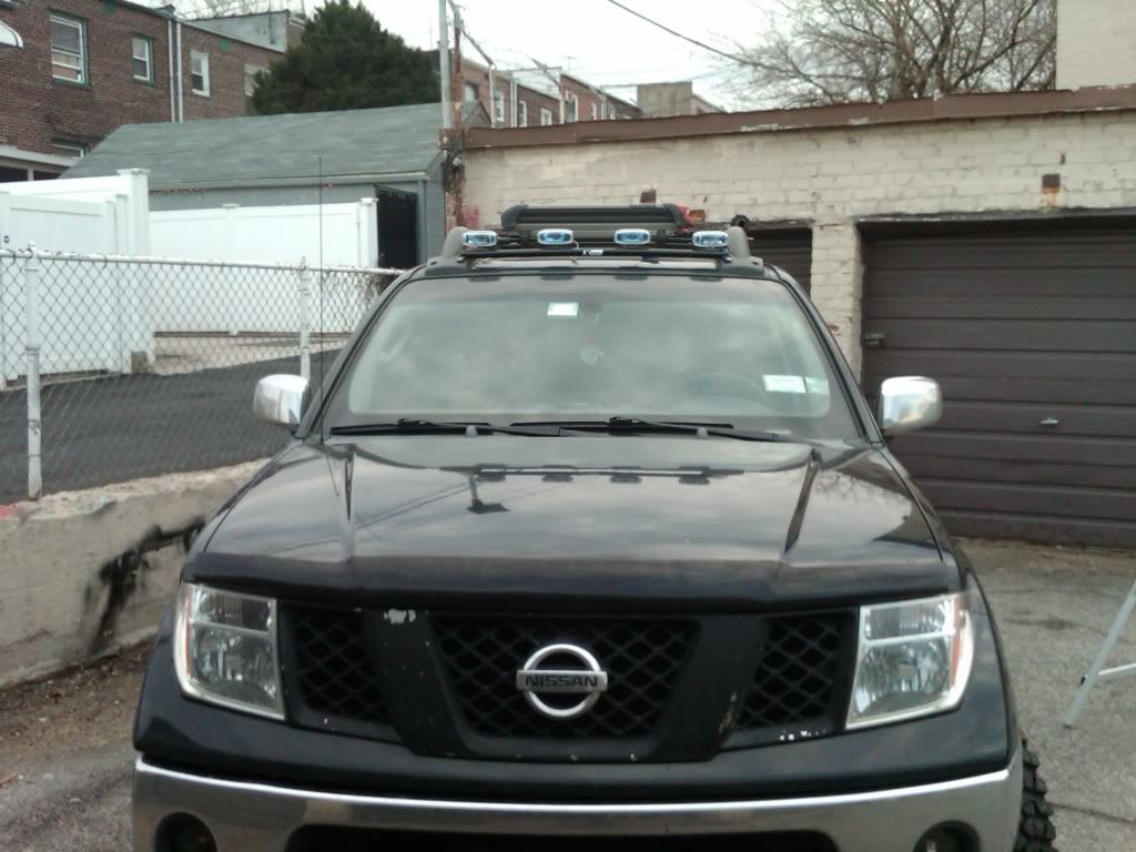

yea i did my grill almost a yr ago but never bothereed to clear cloat it.....guees its time to do it again huh? lolLooks good. Paint yo grille!
Fangars (the guy u makes the Xoskel) has a rack for non roof racks in the works already in the workssweet looking set up, wish i had a rack on the roof to do the same thing
this is exactly how most of the xterra's do it. it's pretty easy to fish the wires thru the headliner w/o pulling the whole thing down. Some have also drilled up thru the roof under the rack feet, then ran the wires thru the tubes of the rack.i did a quick look...it seems like the best route would be to drill a hole right above the sunglasses holder. i can then snake the wires to the drivers a-pillar and then down. shouldn't have to do much disassembly. (knock on wood) this way the only things i'm takin apart is the a-pillar and lower console and not the whole headliner
