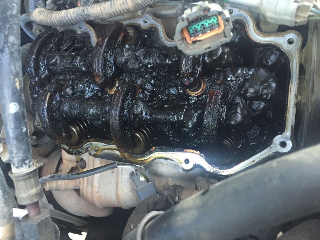

Here comes the bad news, I pulled my valve covers off and found this
Rock solid sludge, and lots of it.
Im not sure If I should have it vatted out, rebuild the engine, or just drop a new engine in it. what do y'all recommend?

Wow... thats pretty bad. If it was me, I'd put a new gasket on that baby and run it till it dies or sell it. That will at least buy some time to decide and save money for when the engine goes. You might have enough time to keep an eye out for a low mileage replacement engine.
Then again it might surprise you and keep on for another tens of thousands of miles. It is being held together with a lot of buildup... probably even retightening tolerances... :)
3,922 Posts
We had a 97 Pathfinder come into the shop like that. One thing I can tell your for sure...and it happened to the Pathfinder motor as well as two, Plymouth Slant-6's I had, do not try and clean the sludge off of the head! It will start breaking apart and bits of it will end up clogging the oil pump screen. If you don't want to put much money into it, then do as suggested and install the new cover gaskets and put them back on. Drive it and continue to change the oil and filter every 3000-4000 miles until it dies or gets to the point of bad knocking or the oil light coming on. At that point you can replace the engine, if it's worth it.
Getting back to the 97 Pathfinder, after attempted cleaning, the oil light started coming on and the lifters started tapping shortly afterwards. We ended up pulling the cylinder heads and sending them out to get steam cleaned and a slight shave and installed new hydraulic lifters. Then, we removed the oil pan and washed out all of the sludge. We removed the oil pickup and washed it out with parts cleaner and thoroughly blew it out with compressed air. We reinstalled the pickup with a new gasket and reinstalled the oil pan with new end seals. While apart, we replaced the timing belt and front engine seals. We ran the engine for about 20 miles and then changed the oil and filter, again. So far, so good and that was a year ago!

At this point, it's definitely not worth dropping a new engine in it.
I'm likely going to sell it and buy a new truck. I love the frontier line of trucks, but I may have to wait to be able to get another one.
