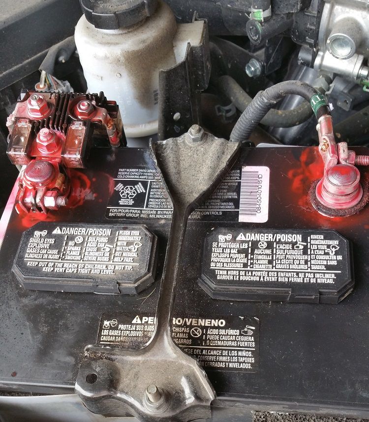

My battery post @ 15 months
My battery after I cleaned the corrosion off
Truck is almost 2 years old and the battery is still lookin' clean!!

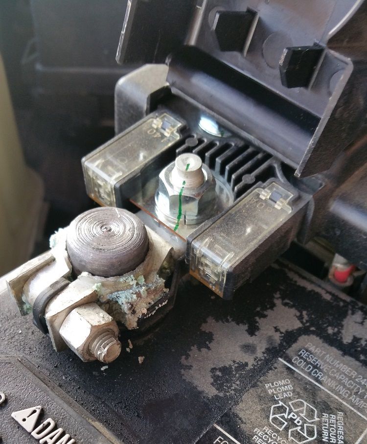

Don't mean to hijack OP's thread but I am having a similar issue with the positive battery terminal.
A couple of weeks ago started my truck and went off to an appointment. An hour later I come back out and get in my truck and tick-tick-tick-tick... wouldn't start. Tried a couple of times and no joy. Pop the hood and I see after lifting the hood of the + terminal that it looks like a blooming onion.
Called my wife cuz she was closer than AAA would be and jumped it and drove home. This was the OEM battery in my 2012 so I just figured that it had a good run and finally died. No biggy, went and got an AGM battery from a local auto parts store. Cleaned the + terminal as best I could and put in the new battery and put the charger on it to make sure it was fully charged.
A couple days later had a Dr. appointment, truck started fine. An our later after the appt. get in the truck and... tick-tick-tick-tick... Tried a couple of times and no joy. Called my wife cuz she is closer than AAA (why do I even pay for AAA :) ). After I called her I popped the hood and lifted up the + terminal cover and I see a bit of fresh powder. Wiggled both terminals to make sure that I had snugged them up sufficiently when I installed the new battery. They were snug.
Got back in the truck and, on a whim I tried to start it one more time. Fired right up!
Fast forward a couple of weeks and I go out to go somewhere this afternoon and ... tick-tick-tick-tick...
Well....damn.
Pop the hood and lift the + terminal cover and quite a bit of fresh powder. Bummer.
Have the charger on it now and hopefully I can get it started tomorrow.
So...I have a new AGM battery with powder forming around the + terminal andI'm wondering if perhaps the problem might be in the electrical system, or is the ECU fubar'd and messing up the electrical/battery circuit.
