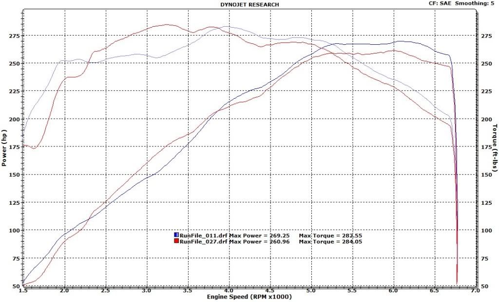

OK. First thing I want to say is this mod is not for everybody. That now aside, let me explain for those that don't know what I'm talking about. VIAS=Variable Induction Air control System. This is the butterfly that is in the front of our intake manifold and is designed to give good lowend power and good upper end power by opening and closing this butterfly at different points to maximize power and airflow when needed. This butterfly is also part of a shelf in our intake manifold. This shelf completely separates the left and right runner ports. When the butterfly opens, it allows airflow between the left and right cylinder banks.
Well, I have been doing a lot of thinking about alternative intakes or modifying our intakes for better flow. So after doing a lot of research on this forum and many other VQ forums, I discovered that some other VQ engines have been deleting their VIAS with documented gains. Generally, the results have been showing gains un the upper end and some loss on the lower end.
So about 1 month ago, I completely removed the butterfly and it's surrounding housing from my VIAS, leaving nothing but the base, reinstalled it, and have been running around testing it out. My butt dyno was backing up what the other VQ's were saying--a nice gain on the top end and a bit of a loss on the lower end.
Well, I finally got my truck back to Uprev to get dynoed again, and tweak the A/F a little to correct for the changed airflow. The runs went well, not quite as good as I hoped for, but not too bad. Now this run was done on the same dyno, by the same operator, so I tried to keep things as consistant as I could. Only main difference is today I ran in 98 deg weather and was getting pretty heatsoaked vs last time I dynoed on a cool January day. Uprev did the graphs in SAE to try to make up some for the hot day, but they said it might not do enough. Because of the weather, I would say my results today would be worse case scenario gains.
Anyway, using my final run from my January cam tune vs todays Vias delete tune, I ended up with a peak gain up 9whp and a loss of 2ftlbs. Now gains at certain points were 15whp and 12ftlbs. The loss occurs from the 2300-3800rpm range and is fairly significant at its peak I admit. And the reason I actually have a slight peak loss in torque even though I have gains 2/3's of my rpm band is that the my previous peak was in the 3300rpms range-right where the Vias delete hurts you the most. So what I ended up with is a gains in both HP & TQ from 1500-2300 & 3800-6800rpms. Again losses were from 2300-3800rpms. It's a give and take.
Anyway, from my personal experience driving around for a month, even pretuned, I love the mod. Under good throttle in lower rpm range I can feel a power loss and while cruising at low rpms on the highway, i could also feel a slight power loss. To me they were both very slight. As for gains, my truck now pulls very hard from 3500 all the way to 6800K. You can really feel the difference in power when you get on it.
For me and my style of driving, this suits me well. It also works well with my cams which also love the upper end. And for the track it should be great. I will only be in the 2300-3800rpm band for about 1 sec in 1st gear and from there on I will be 4K+ which is were all my gains are.
Now for other VQ owners. I think generally the heavier your truck is, such as off road modded 4 x 4's, this mod would not me a good idea. Also for automatic owners, this mod would have it's downfalls, since your transmissions like to keep you generally in the power loss range. As for the average 6-spd or even heavily modded automatic, this is a mod worth considering. It really boils down to your driving style. But the gains are there for the taking, and best of all these horses are FREE!!!!!

I've really been wanting to post up about it for some time, but I really wanted an Uprev dyno to backup the gains I thought I had gotten. I saw a few times looking back on this forum that the VIAS was experimented or questioned, but at the most, people only blocked it it open. In fact the Aaron guy with NWP that was trying to get intake spacers made for us, was actually the company making VIAS block plates for the vq35 Maxima & Altima guys. And as a note, due to the unique design of our VQ40 VIAS design, a block plate would be difficult to design, and is possibly why he didn't push it on us. Anyway, To my way of thinking, there should be no or little gain in just blocking the VIAS open. You would lose your usual lowend power but the upper end I think would stay about the same since it is usually open on the top end anyway. Removing the entire butterfly and its housing opens up, I would say, maybe 1.75 times as much opening for more airflow. The other thing I noticed also was that when the butterfly is still installed, even when it was open, it partically blocks the 1st two intake ports. So for me, the removal was the only logical test for its possible gains. And I do want to thank shinermiller for helping me research and experiment with this mod. He has been trying his out blocked open for several weeks. His gains appears to be similar to mine via his butt dyno, but probably less loss and gains do to the VIAS still being in the intake. He did say with his auto 4 x 4, the lowend loss was sorta annoying.

pretty interesting how it flat lines pretty good right at 5400 or so - any idea's there?
As for the flat lines. Our engines all tend to do that on top. Mine just happens to carry the power longer in the rpm band so its more noticeable on my dyno. Most VQ40's only flatline from maybe 5300-5800 than drops. Mine flatlines from 5400-6300rpms. Not sure why we all do that.
I'd guess it's a little extended because of your cams. In any of the race engines I;ve built or seen or dyno'd, they flat lined like that simply because either the exhuast or intake (runners in the head, intake runners, intake runner length, ect) were becoming a restriction.

I mean, it depends what the issue is... There is no straight answer. A change in the profiles to the cams may help, changing the scavenging effects of headers... I mean I would tend to think this is probably more on the intake side personally, but I've never seen the intake base apart... I'd have a hard time blaming the heads since 4v heads flow usually really well.
I mean all engines do end up flat lining, what surprises me is how soon they do in the RPM range... I would have thought that these motors would be pretty happy to rev past 5500...
