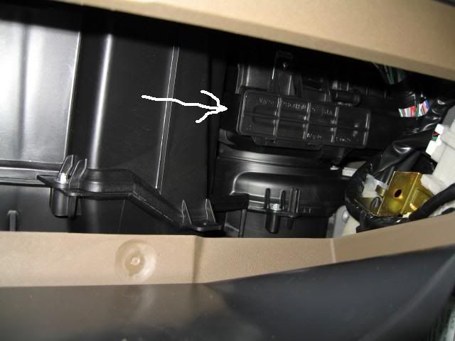

In the picture do I need to unscrew these small bolts to gain access to the filters? Also what is it that breaks easy if your not careful? I remember somebody mentioning something.
Automotive exterior Vehicle Auto part Car
859 Posts
1,560 Posts
At most, there might be a screw holding the door shut.
There is a tab (that you will probably break) that needs to be gently moved to remove the door. I don't know of anyone that has not broken the tab.

The release tab can snap off. When installing the first filter I used a paint mixing stick to push the whole filter over to the right so the left one fit in easier. They sit side by side to create one piece to cover the opening.
