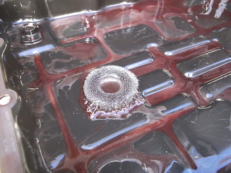

you can drain it and drop the pan and clean the magnet off if you want to be really thorough, at 100k, mine was pretty fuzzy looking.
