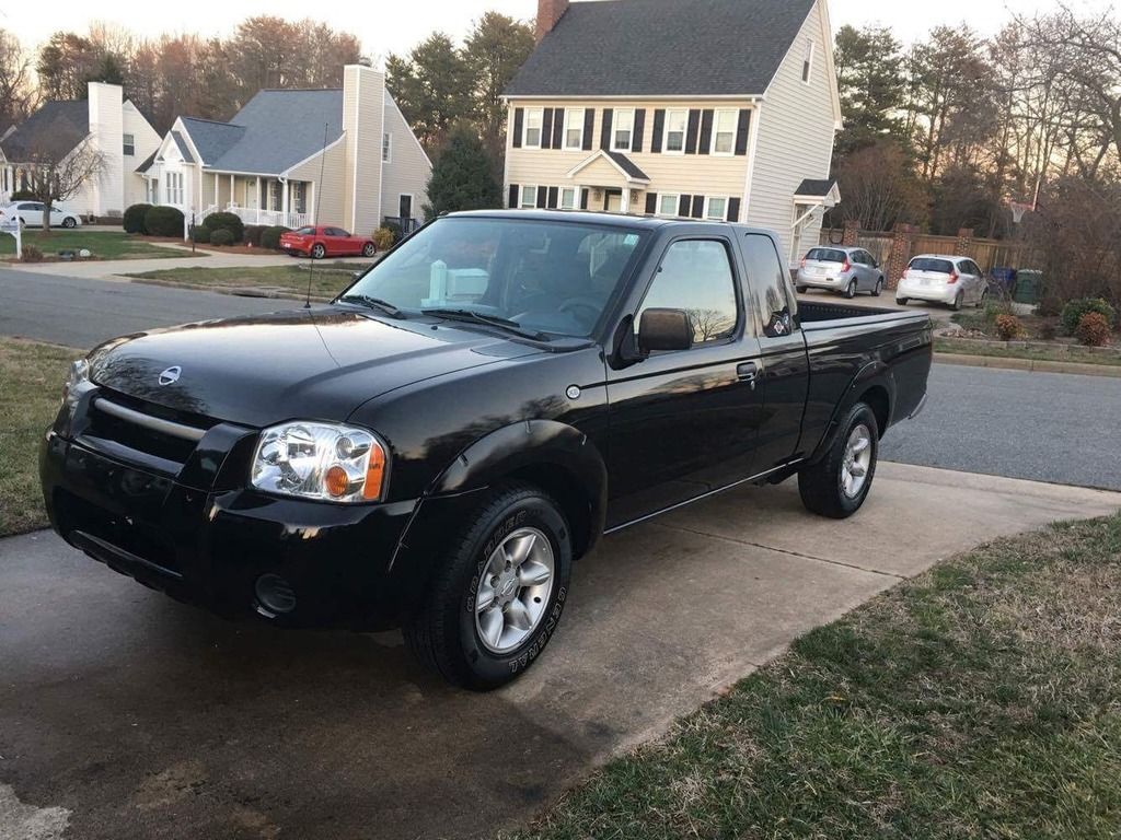

My ’02 XE 2.4 has recently been assigned tow vehicle duties for my small bass boat. I have typically installed a transmission cooler on the automatic trucks I towed with in the past, what do you guys recommend I do with this 5 speed?
Towing capacity is not an issue, and neither is braking, although I do plan to upgrade the rotors and pads. I live in a pretty flat region, and I can take slower state highways and backroads to almost every lake I fish. Suggestions on how to prevent unnecessary wear and tear on my truck would be appreciated.
