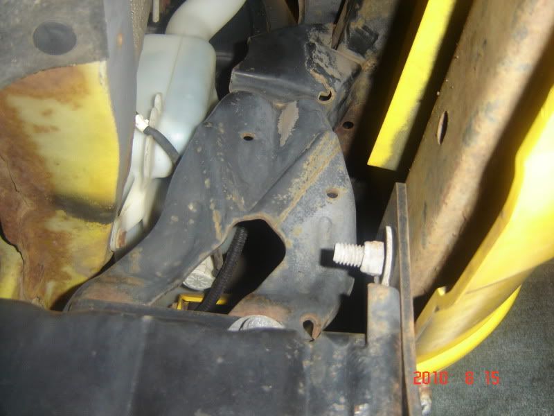

I know there are TON's of threads already that are about the squeaks of a nissan. But all those don't help me in my problems with the infamous squeak. so ive including pics of where the squeaks are coming from.if any body know how to handle this.please help me out!
so if i bang this =
whic is connected to this =
it makes the exact bird chirping squeak noise that ive been hearing.but when it rains or i wash my truck.it doesn't make that noise until it dries. any body know any remedies to this? or have the same problem. or better yet any nissan mechanics out there? please help :sickly:

do you think its gna be alot of work?that means i gotta take off my whole front bumper eh? i just got done fixing it lol because it was loose.:fantastic:
Does it still chirp after you tightened it? Maybe just loosen it and squirt some grease between the parts and tighten it up again.
Had the same squeak. Couldn't see it but plenty annoying. Look for the extra rust streaks that should be there or will soon be. The top of the upper bumper and the [62242P] RETAINER-FRONT BUMPER UPPER CENTER were rubbing.
I fixed it by lowering the bumper bracket a little bit. Just loosen the frame rail bolts on each side, lower and re-torque. if that dosen't fully cure it, you may have to raise the retainer a hair. They are very close together up in there and with the plastic cover on, it's difficult to tell where one starts and one ends.
Click the thumbnail. I circled the metal retainer and dotted to the upper bumper where they rub when put together. I use blue threadlock for just about every bolt on the truck.

that is exactly where its coming from. after i did my brakes today i got a better look at it.so now i know what to do.thanks!
