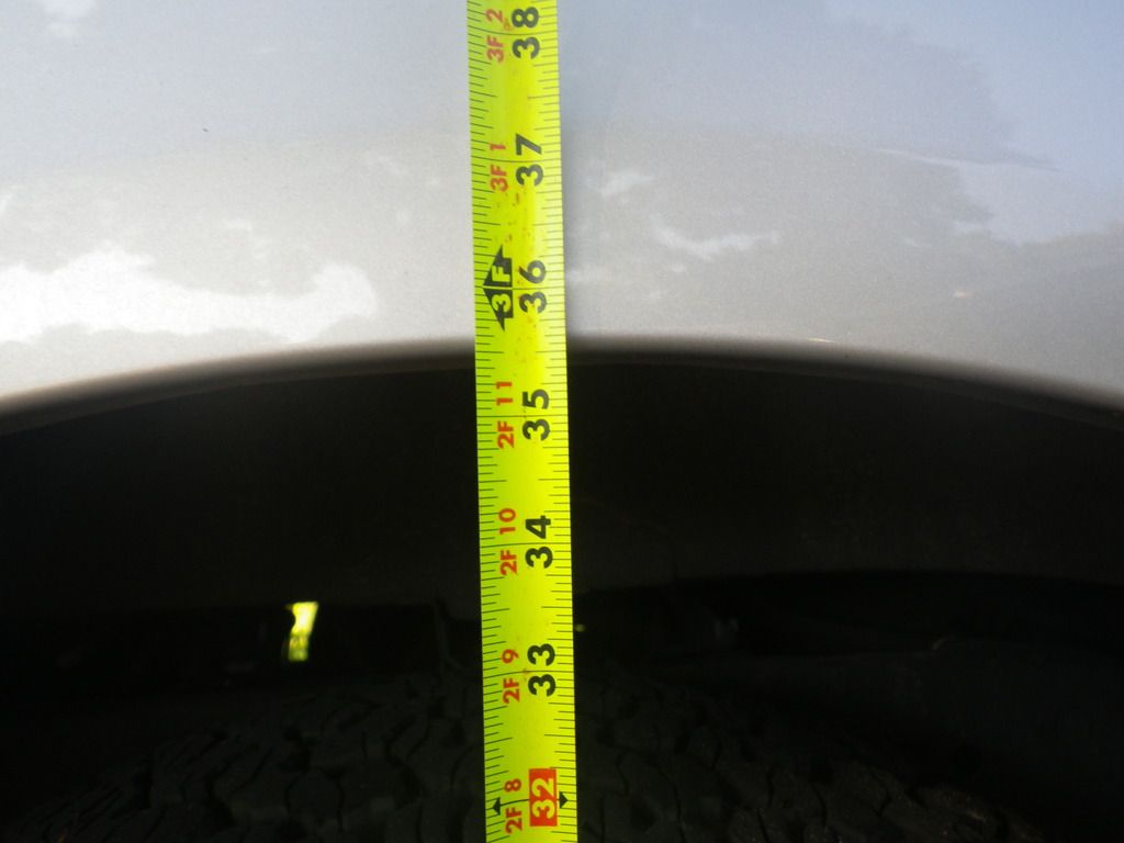

Height of rear when unloaded
Height of rear with boat hitched up

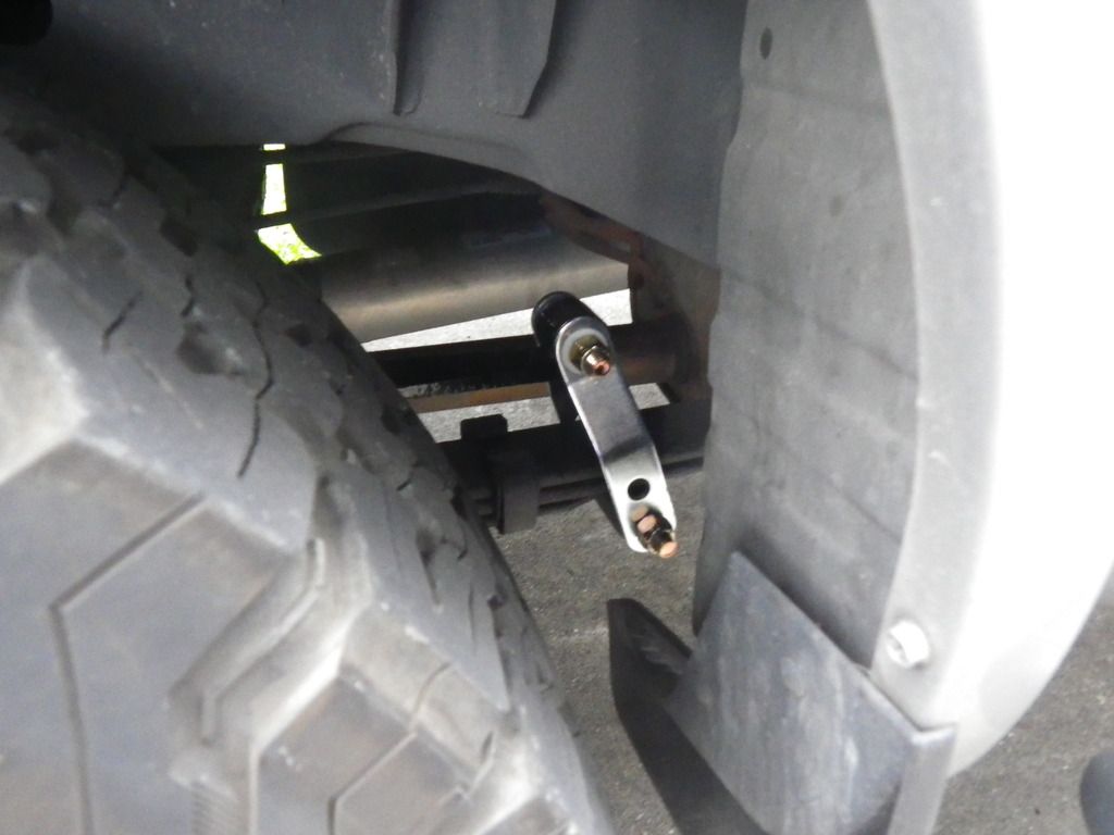

First step after lifting the truck (by the frame) is to trim the bump stop to fit the mounting bracket (only needed for spring over configurations).
Next, bolt on the bracket, then install the spring and clamp the spring to the bracket - was simple, even for me!
The install resulted in a little over an inch of lift. Even though I wasn't looking for lift, it was less than most of the other AAL or leaf pack options I looked at.
Her it is with the boat hitched up - about 3/16" higher than empty before the install.

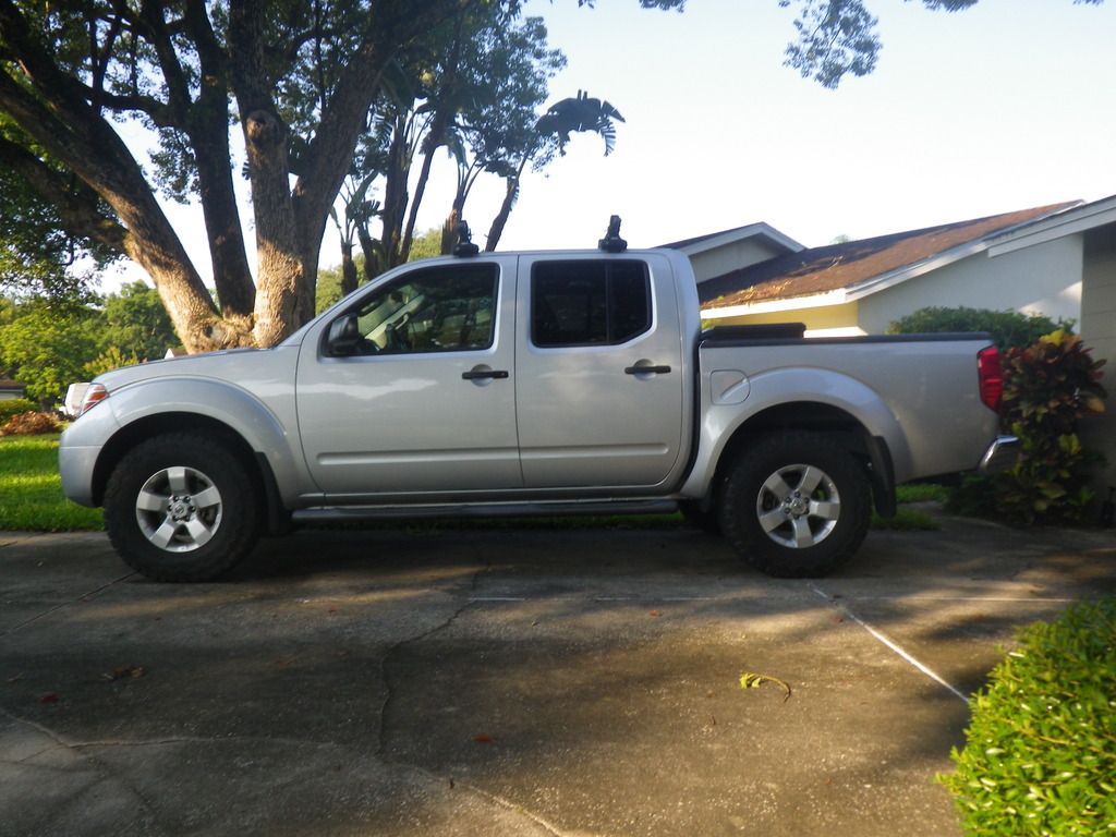

Here is how the truck sits on my (slightly slanted) driveway.
Here are a few shots of the springs after the install - they actually have a bit of arch to them now…
