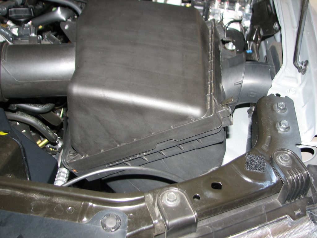

While we're on this topic, my hood squeaks on my '06 depending on the road surface. No matter how I adjust the rubber bumpers or what lubricant I use on the hinges, latch or rubber bumpers, the squeak returns in a few weeks. (I have the Nissan Hood Protector on mine, which slightly closes up the hood clearance if that is a clue.) Does anyone else have this problem?
595 Posts
Yes, and I tried all the things you did too. Ended being the rubber stops; I put a piece of velcro under each stop and that fixed it. No more squeak (at least not from the rubber stops).
742 Posts
I did this and the wiggle is apparently so pronounced the velcro tabs adhesive slid under it.
4,015 Posts
Excellent idea -- I'll try it! Nothing to lose.
