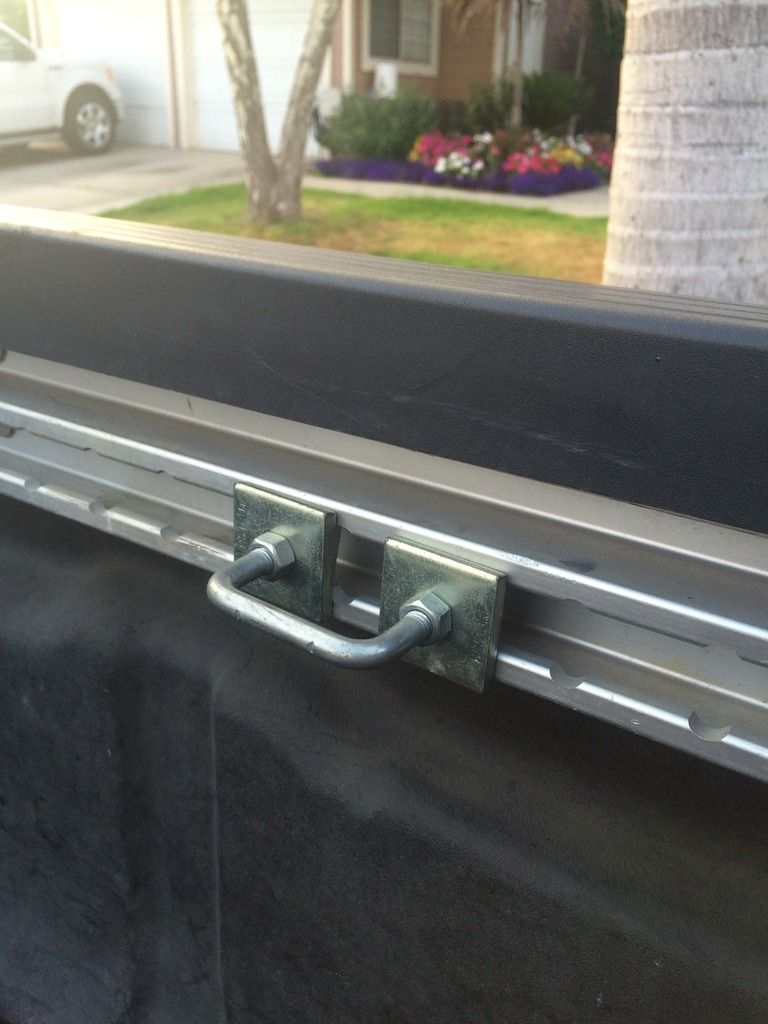

I'd look in to running a threaded rod in to a Unistrut spring nut. a fender washer and a nut to secure it to the rail and then a washer and a wing nut to secure the spare to the threaded rod.
Similar to how I did these eye bolts. Swap out the eye bolts for threaded rod of the proper length and blammo. Mounted.
Thanks.. I got this little set up. I'll just need to grind the spring nut down a bit so it could fit the bottom utilitrac.
