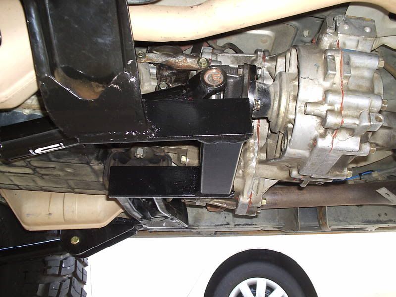

you are also going to have to modify the tcase crossmember for front driveshaft clearance.
