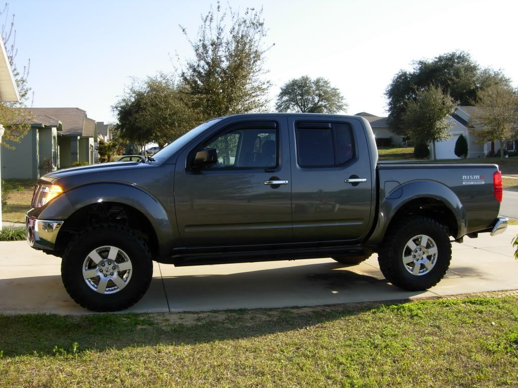

My truck is very basic but I get a lot of PM's asking for info about how it is set up, so here we go!
Username: Sangster
Year: 2008
Make: Nissan
Model: Frontier
Trim: Nismo
Color: Gray
MODS--
Interior: Escort radar detector, Cobra CB, Alpine single-din stereo/DVD player
Exterior: custom "Ocala National Forest" pinstriping, dented front bumper, hi-lift mounted to utilitrac, removed mud flaps
Drivetrain: stock w/synthetic fluids, rear diff vent hose
Suspension & Tires: 3" ebay coil spacer in front, adjustable A/C shackles in rear, 2" 4x4parts.com body lift

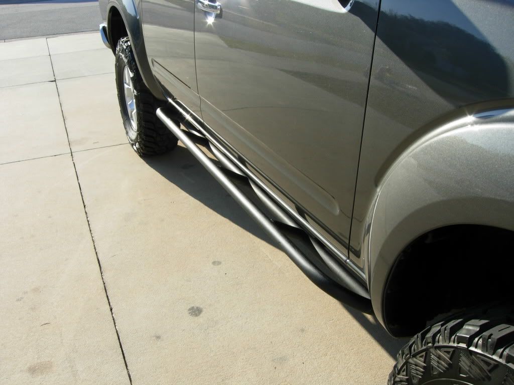

Armor: stock smashed up skid plates, custom built (thanks shawn!) sliders
Performance: K&N air filter
Gear and Other: hi-lift
In Progress: On the list of to-do's---Titan swap w/PRG uppers & coil overs, rear PRG leaf pack & spacers, real skid plates, winch bumper w/XRC8 winch, rear bumper w/shackle mounts, headers, y-pipe, catback, snorkel
Pics:

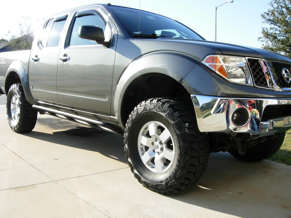

Kumho Roadventure MT's in 285/65/16
Love them offroad, except I can't seem to get them balanced. When they are done, I'll be going with something different.
any rubbing with the kumhos?
no rubbing at all. I added them after the coil spacers and body lift. Mud flaps have been off for 80k miles. Ripped a few of them in half on some rocks not long after I bought the truck, so I took them off and trashed them.
