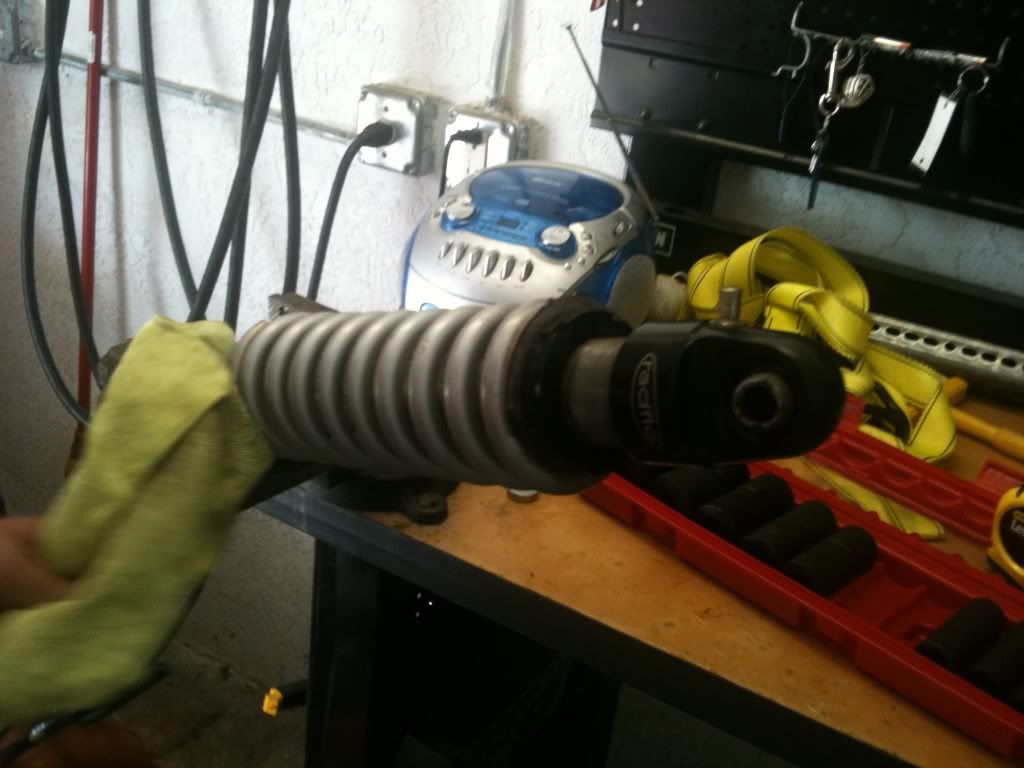

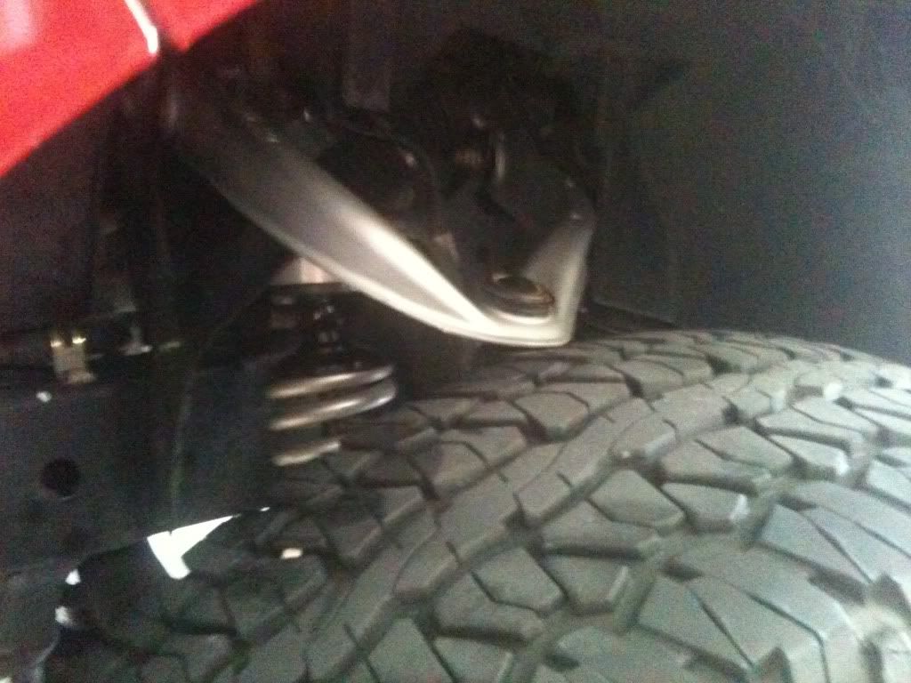

Hey guys, I am in the process of installing my 2.0's and have hit some problems. A lot of my problems lie with the fact that i have a 3in spacer on top of them. I have completed the driver's side but i had to loosen the nut on the radflo down to only 3cm off of the bottom. I dont think that will cause any problems and I gained 2in lift with it.
My question is this, Why do I have less space between my arm and coilbucket now? I am titan swapped and I have little room between my arm and bucket.
I am running stock titan uca's so i can upgrade those. Rough country or calmini? Prg's are too expensive

If you back the coilovers off a bit, you will raise the UCA away from the coilbucket, but lose lift in the process. When my 2.5s went on I had the same problem, so I just cranked the coilovers towards the top with the spanner wrench and I gained clearance from the arm and coilbucket and down travel.

You'll be replacing those arms down the road when the ball joints go out on ya! Trust me. That's why I now have Camburg arms. I'm running 4" of front suspension lift and have lots of down travel, but the stock ball joints dont do well at that angle. Its much better w/ the camburgs. The stock titan arms would hit the c/b at full droop, but my Camburgs are designed such that they never contact even at full droop.

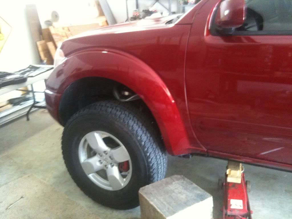

Ok mike, I have 41inches from the ground to the highest part of my front wheelwell. There is 8.75inches between top of tire to top of well. I am running 285/70/17 (33in) no rubbing.
How do I measure down travel?
By the way it looks like a monster truck now...
9,811 Posts
Measure from the center of the hub to the fender arch with the truck on the ground, then measure again with the front end lift jacked up.
