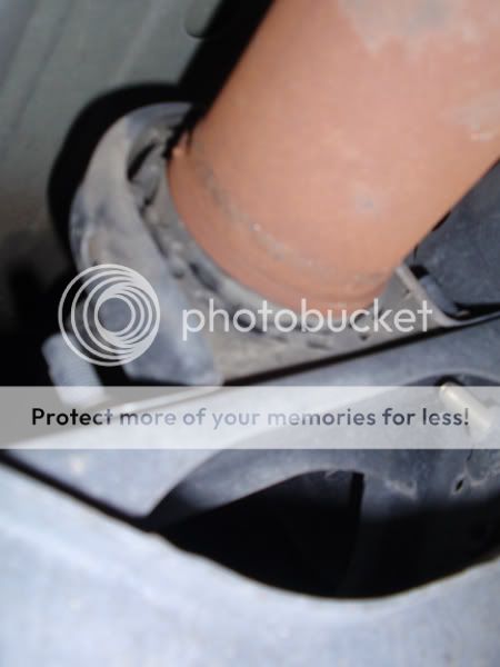

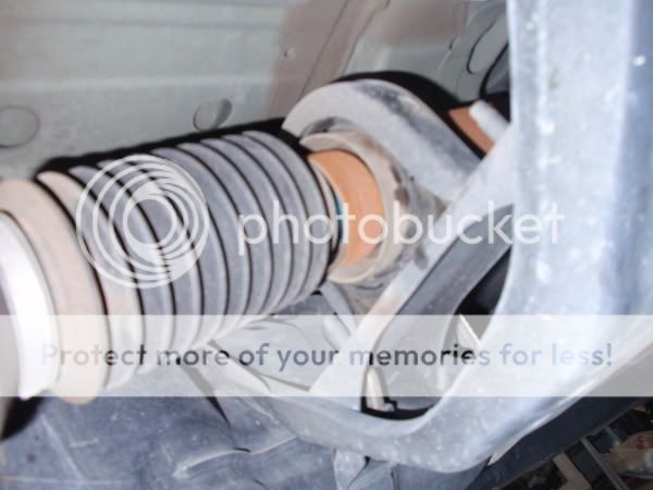

My truck just broke 60K miles and I took it into a shop for maintenance, and a full check up. Tech noticed some slight play by having the truck in Neutral position with the rod that extends from the differential towards the front end of the truck. Asked if I had noticed any vibration and it would be mostly felt in the rear bench seats.
I'm having a language barrier problem here. As I need a part and don't know what it's called in English. After some Googling, I believe it is part of the Propeller Shaft and the exact name on the part needing replacement is the "Internal Center Bearing."
Here are shots of underneath the truck. The red arrow is what I understood needs to be replaced. If anything else looks wrong/off or should be checked out by another tech, please let me know.

Driveshaft Or Prop Shaft For The Other Side Of The Pond People(ie Uk) Unless It Has Pretty Severe Cracking Or The Rubber Is Breaking Apart Severly Distorted I Wouldnt Worry About It. Be More Concerned About U Joint Condition
you should fix it, for the vibration will only get worse. i believe its called a center carrier bearing. propeller shaft also knows as drive shaft.
if its in your budget, i'd get a one piece drive shaft made and ditch that bearing. they are notorious for going bad
You should only need part 2 in the diagram but if it is all coming apart to replace the center bearing it would be a good idea to have all those u-joints (part 4) checked out as well or just go ahead and have them replaced if money allows, you sure dont want to do the center bearing and then find out it all has to come apart again because U-joints are worn or shot.
the only u- joint on the 2wd driveshaft is on the slip yoke that goes into the transmission , the rest are cv's

Yup, you did have it right, part 2 and maybe 1 to go with it!
Thanks, Bimmernut. Alright so I'm going to ASSUME Part 1 & 2 are sold together.. because I'm not having any luck finding the plastic on its own.
Just called a friend who was with me, just to double check, when the tech grabbed the rod it would move a little up and down. The plastic is shot. It wasn't gripping. Stretches too much.
That may be the case, I haven't done one but all my BMW's come that way, no way to replace just the rubber or the bearing. Shouldn't be that big of a deal though.
Great! That answers that one then. :D In any case, when the entire piece comes off it'll be fully inspected. That's how I found out about this in the first place, lol. :)

im not saying the stock setup is unsafe. but that driveshaft, as it appears, is like the one on my old hardbody. it is a two piece drive shaft separated (or cnnected) by that bearing. i was constantly replacing the center bearing. which was a pain because on that truck they were balanced, actually had small weights on each end of the shaft, for the very same reason you are experiencing, preventing vibration. i had a local shop make me a one piece shaft, therefore eliminating that bearing. once that i did that, no more vibration. with the original shaft, i'd go thru u-joints frequently too. one piece shaft, put in new on install and never changed em again
