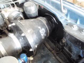

-Larger Blitz intake to replace K&N Apollo II while retaining my cold air intake setup:
Overall hardware setup has been repositioned for optimised efficiency: IC piping is now short and straight, turbo sits higher and more to the front:

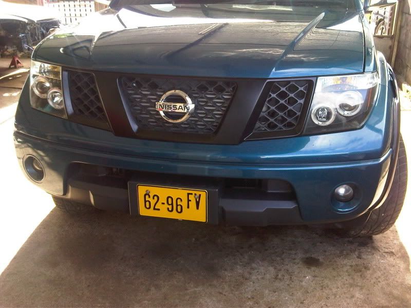

Only the bare aluminum of the new IC gives away what has changed under the hood:
It could almost pass for OEM, couldn't it?

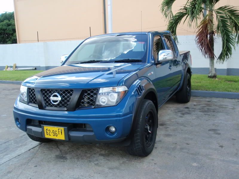

Got a link to the wing and the gilled fenders? those are the tits!

I found the Wing at the end, thanks!
But my other question was more so the entire front fender you have it GILLED. I did read you seperated the intake from the engine compartment. So is it safe to assume that its a factory fender and you gilled it yourself for more airflow?
There are simmilar ones for my honda that i can purchace, i just thought yours would be as well.
Yes, the gills were cut and beaten by hand out of the original metal fender. I did buy an ABS plastic intake of the same shape initially, and I intended to have that cut and bonded in, but the guys at my bodyshop were sure that they could reproduce the same shape by hand out of the fender's original sheetmetal.

Isolating the intake from the hot enginebay air is just a simple plate with rubber ring snug around the filter's suction bellmouth (assuming that you'd use an enclosed filter intake such as the K&N Apollo or Blitz Sonic).
