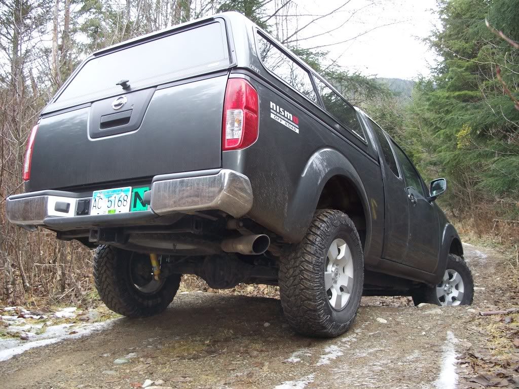

Tire is off the ground, I parked it and checked my lines:
Love how much slack is in the lines :) Shock is holding it back.

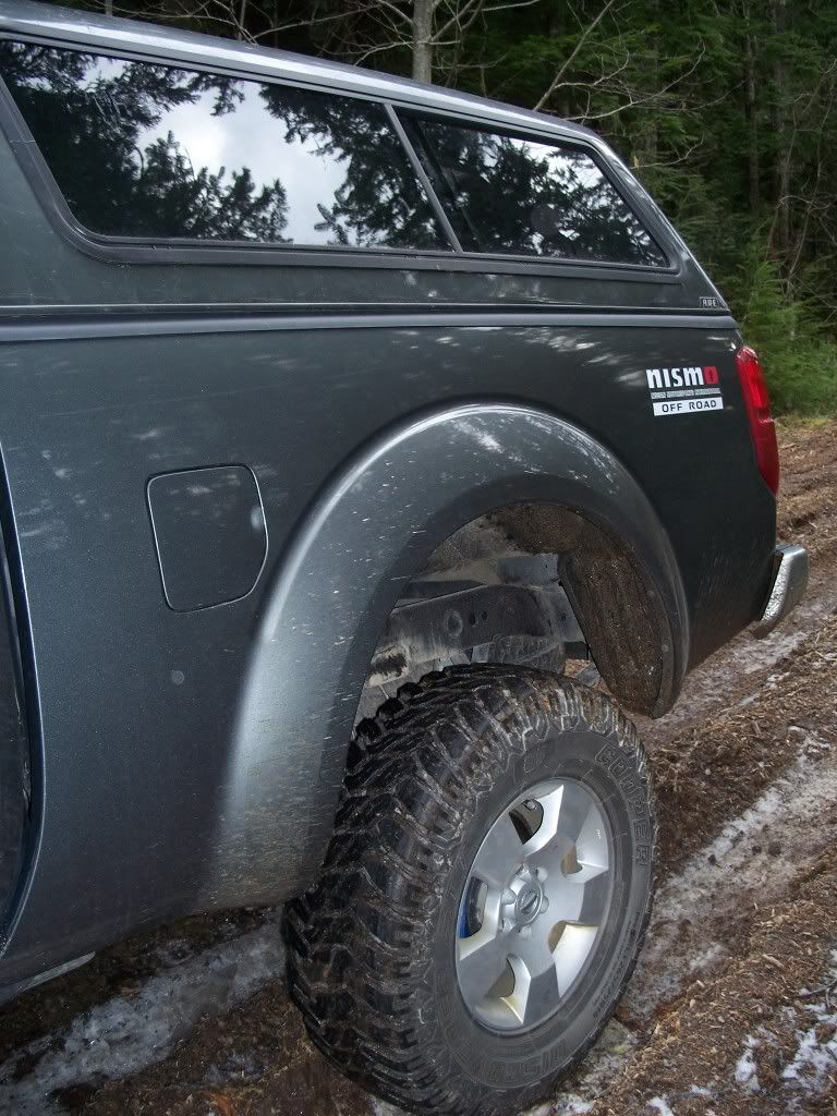

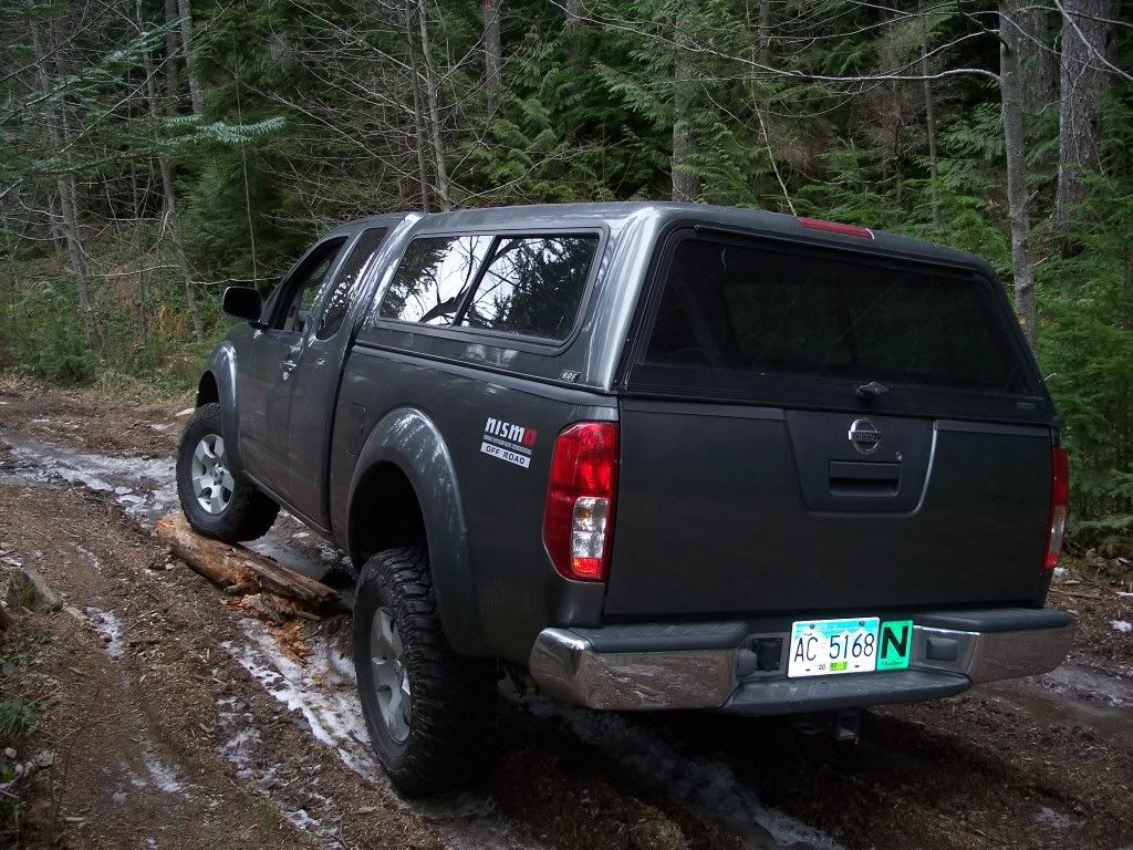

Rear rides nice. Stiffer than stock (because of the deavers) but still nice. The Radflo emulsions should improve on this once I get them on there. I've had my deavers on since May 2008 so the rear end was sagging too. Here's a side shot, although not really level... there was a hedge in my way! I can get some better ones tomorrow.

Yup, exactly why I ordered the 1" blocks too. I put in the arms and coils first yesterday and let the truck sit on it's own weight with wheels/tires. The back measured exactly an inch lower than the front so I put the blocks in and it's now level!
