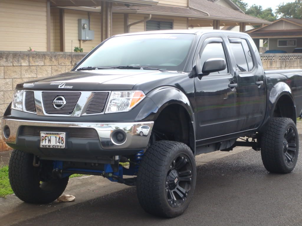

EVERYONE WHO HAS POSTED ON MY OTHER THREAD i WANT TO SAY THANK YOU. BUT I STILL HAVNT SEEN WHAT I AM LOOKIN FOR.....OK ...OK...OK...I WANNA RAISE MY TRUCK UP TO "BIG TRUCK STATUS"....I DONT DO ALOT OF OFF ROAD RIDING BUT I WANT MY TRUCK TO HAVE THAT APPEAL & LOOK. I AM NOT MECHANICALLY INCLINED NOR DO I UNDERSTAND ANY OF THE FORGIEN LANGUAGE THAT YALL SPEAK ON HERE (LMAO!).....I NEED PIX....AND LIST OF MODS THAT I NEED TO GET TO ACOMPLISH THE LOOK THAT YOUR TRUCK ALREADY HAS. I WANT TO BE ABLE TO PUT 20" WHEELS ON & ALSO FIT A NICE SIZE TIRE ON IT ....I AM WORRIED THAT IF I JUST PUT THE LEVELING KIT(2.5 & 1.5 READYLIFT) AND THEN PUT THE 20" WHEELS WITH 285/50/20 TIRES I AM NOT GONNA LIKE THE LOOK OF THE SHORT WALLED TIRE. NOW IF I AM WRONG IN THAT ASSUMPTION PLZ LET ME KNOW CUZ I HAVE NEVER OWNED A FRONTY B4 AND NEVER ATTEMPTED TO HAVE ANY MY VEHICLES CUSTOMIZED. NOW I DO PLAN ON DOING SOME OFF ROADING AND PUTTING THIS MONEY TO WORK SO PLZ BARE WITH ME IMA NEWBIE! LOL....PLZ POST PIX AND MODS THX NATE OOHH YEAH I HAVE A 2010 SE CC 4X4 :nana:

It sounds like you are going for looks alone with some 20" rims. If you are doing that, then just do a spacer in front and possibly a shackle in the rear. This is the simpliest thing that you can do.
If you want to go all out and make it a beast, then use the Calmini 5" with a Tswap and extended COs. For the rear, a custom leaf pack (prg, alcan, hybrid, etc...). Then you can have the "BIG TRUCK STATUS" as you call it.

If you are really goin for the "big truck" look than don't even mess around with the small ready lifts or anything. Your best option would be going with the 5" calmini suspension lift. It's the cheapest lift kit I can find and it will really give your fronty the "big truck" look that you are searching for. I'll post a link to where you can get it for the best price. As far as your rims go...I really wouldn't recommend 20"...I would say get an 18" rim with a 35" tire. That looks the best for sure!! Good luck with your fronty build...hope this helps...Screamin Lizard Customs - Hemi JK Conversion Experts Screamin Lizard Customs, Hemi and JK Conversion Specialists website. Screaminlizard.com, your Hemi JK Conversion Experts.

I wouldn't even go on a gravel road with 285/50/r20's let alone off roading. 20's are mainly for filling in the wheel well with "bling" hense just using the leveling kit for clearance. Putting a larger lift with those wheels will make it look like a hay wagon. Stick with 18's and 35" tires.

not sure if this guy is a member here but he was one of the first i have seen to have a lifted second gen frontier on twenties.
click on the pic to check out his cardomain page. goodluck!
also, a member here, 808blkfrontier lifted his truck and had 20 inches with 33's
IIRC he had the Calmini 5" plus a 3" body lift....
click on pic to go to the thread
22 inches on 35s
click to go to the cardomain page
and here's a tire calculator to help you figure out tire sizes. my truck currently has 32 inch tires on stock suspension and wheels. with a mild lift, 33s can fit with little to no trimming, depending on the rims
tire calculator

WOW....FIRST OFF THX TO ALL THE GREAT POST & ESPECIALLY CARPHREAK....THE FIRST POST THAT HE PUT UP OF THE 5" CALMINI LIFT WITH 20" WHEELS IS EXACTLY WHAT i AM LOOKIN FOR. AS FOR ALL YOU OTHER PEPPS ON HERE MAKIN YOUR COMMENTS ABOUT PROPPER GRAMMER....AND I SOUND LIKE A 16 YR OLD KID.....PLZ GIVE ME A BREAK ii THOUGHT THIS WAS A SITE THAT GROWN MEN WHO LIKE TRUX ....GUESS EVERY TREE PRODUCES A FEW BAD APPLES BUT ONCE AGAIN THX TO ALL THE OTHER GREAT POST THIS HAS BEEN VERY HELPFUL FOR ME TO ACCOMPLISH MY VISION......I WILL BE POSTING MY PIX VERY SOON THX NATE

shift-This's old truck before he traded it in
[/IMG]
as for the 285 50 20s this was my truck with a 1 in drop up front so if you lift it you'll want a 285 60 or 65 tire at a min with a 20in wheel
