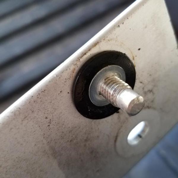

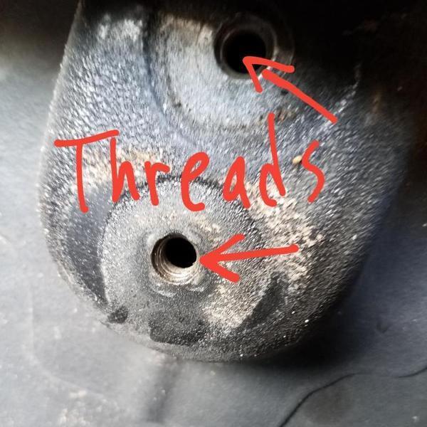

2. With you T40 Hex bit begin removing the bolts that attach the tracks to the bed. The holes are threaded so don't worry about not being able to get it back on, you'll be fine.
a. There will be some washers that fall as you remove the bolts, so don't misplace them.

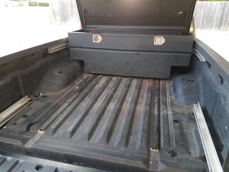

3. Remove all of the bolts on the rear 2 track pieces. (the ones closer to the tailgate)

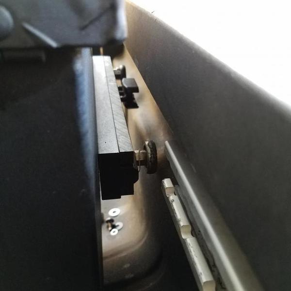

4. Unlock you toolbox and slide it forward and off of the tracks. This is where it being empty helps prevent damage.

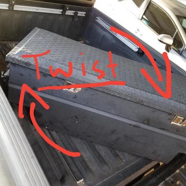

5. Now when it comes to removing the toolbox be advised that the fit it tight! I had to twist the box towards the rear of the bed to get it out.

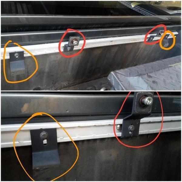

6. On the rear there are 2ea bumper stops (orange) and 2ea locks (red). Both are simply removed by loosening the 7/16" bolt and sliding them out of the tracks.
