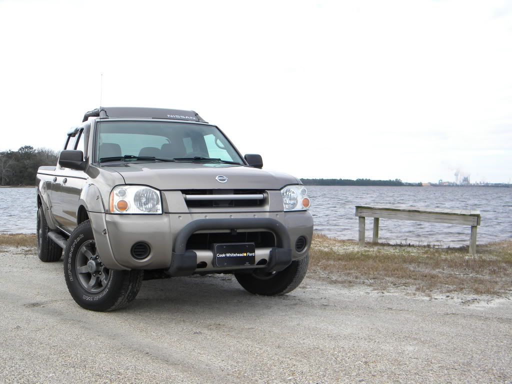

heres a few shots i took today
4
Truck looks really nice, good find.
Is that Cape Canaveral in the back ground?

no thats the papermill in panama city haha. yea i hope everything goes well on this trip!! haha.

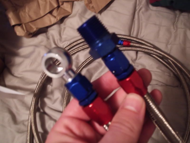

i have this;
B&M 70297 B&M Hi-Tek Cooling System
and i had these lines made to replace the hardlines and run stainless braided from the tranny all the way to the cooler. i completely bypassed the factory cooler, which is built into the bottom portion of the tiny frontier radiator.
when i first added a cooler, i tried to go the economy route and it really bit me in the a$$. i had to constantly babysit the hose clamps because they would come loose and leak. i snugged them up before a trip, and when i was in the desert womping around, the clamps quit and puked tranny fluid everywhere.
i decided that my tranny sees lots of stress, and quality is not something to skip on in high performance applications, especially when i'm going to be in the desert.
the total cost was around $430 for that cooler and those lines.

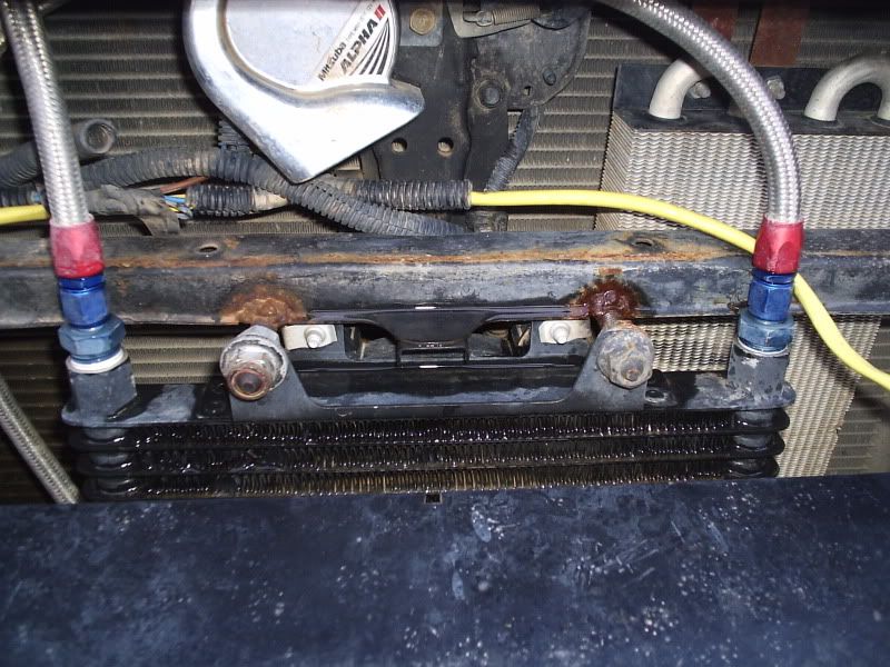

the cooler is mounted with some minor custom fabrication. i'm talking a couple bolts welded to the front crossmember and a 1/8" strip of sheet metal that secures the bottom of the cooler.
b&m recommends mounting the cooler so it receives the fluid from the top, and i don't have a ton of room up front because of my other mods... so i had to ditch my grill. you could probably find another way to mount it without a problem though.
the cooler you see in the back ground in the pic below is my engine oil cooler. i have never had a problem with it, but the same setup for a transmission cooler just didn't work well for me.
