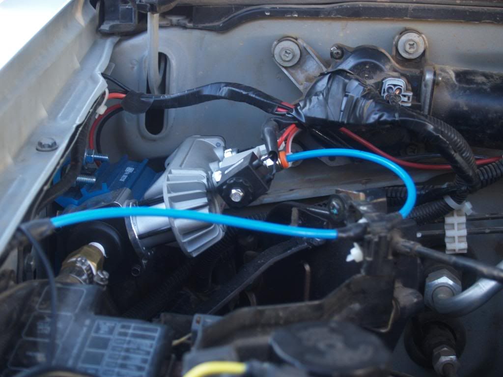

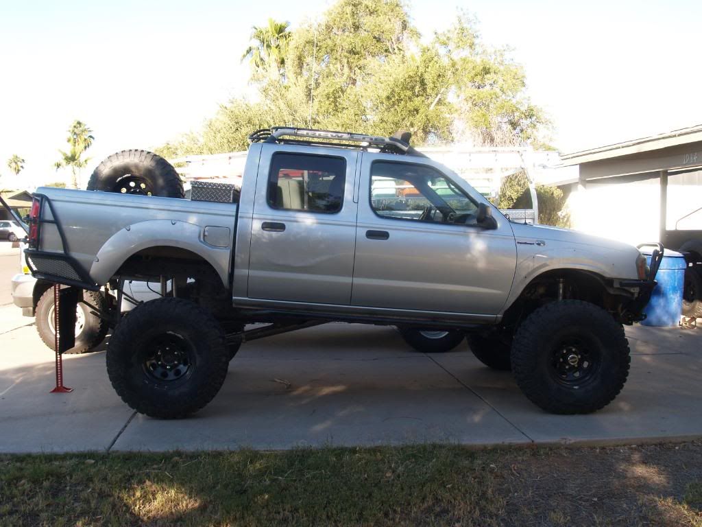

well for christmas Natalie went half's on an ARB locker for the front so now im locked front and rear
bought the new arb compact air compressor for the lockers only
installed one more leaf to the chevy leaf pack to level out the truck and modified the spring clamps to get full flex out of them
Natalie painted the metal on the mudflaps so we can run those here are a few pics

hmmm I thought there was no way you could an air compressor under the hood. In these trucks there is just no room. But after looking I see that your truck lost its cruise control mech.
Besides the engine bay the only other place would be above the frame below the body and or the truck bed.
??? cruise control is still there
i just modified the bracket it was mounted to , in the 2nd pic you can see the new cross brace i made for that bracket right under the compressor

What kind of leaf spring clams are you using? And how did you modify them?
the clamps bend around the leaf pack at the top leaf , all i did was heat those up so they stand straight up now
thats how the 10 leaf pack from prg is done with the clamps straight up

that bumper is really cool. i know that's not what you are posting but i think it looks awesome. that compressor looks like it would be a blast
Oh it's just hard to see from the pic. All I know is I have a sperate fuse box right there and getting to it is sort of tight.

yeah you can see the fuse box in front of the air compressor , the reason i chose that spot is because it will be protected from water etc
i did have to modify a few things but i think its a better location than somewhere under the truck
