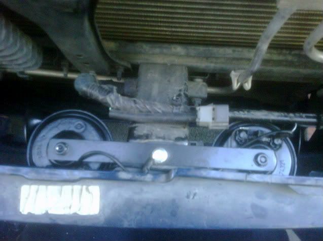

Hey everyone.. I figured I would post up pictures of my Volant install.. This was on my 2010, and was the 125406 kit for the 2009-2010 model with the Powercore filter..
Volant removed the horn bracket and ram air scoop from this kit.. Instead of the horn bracket, they provide two holes for mounting the factory bracket. Unfortunately, I dont think anyone at Volant actually verified that this would work -- or if they did, they don't tell you how to make it work. As you can tell from the picture, the holes are located right next to the headlight harness:
What I ended up doing was what renofrontier did with his.. I removed one of the horns from the bracket and wedged it between the Volant box and the headlight.. Then, reversed the position of the bracket so that the other one was kind of angled around the box. Its not pretty, but it works -- and was the only possible way I could come up with for getting the horns and the box in there. If I had more time and patience, I would have relocated them and extended the wires -- but, I didn't.
The rest are just some pictures of the install -- really doesn't look any different than what others have already posted..
Tie-wrapped breather tube from diff
Tight up against the brake lines from the ABS controller

1 - why is the side air scopp not on there?
2 - why not simply extend the lines and mount them up front, where they work best ayways?

I guess you just looked at the pictures and didn't read what I posted..
The reason they did this is because the area where the scoop goes is now blocked on the 2010.. A portion of the condenser blocks where it went on the 2008 and earlier Frontiers.. Additionally, there is also a plastic panel next to that part of the condenser that completely blocks off the front. The reason I mentioned the part number in the title is because this is the new 12540/125406 kit for the 2009-2010 models.

i did read....didnt see where it said "i took pics without the front scoop on"...horn - guess i was thinking it would take less time than to try to make it fit to Volants holes. heck, you gotta drill out the holes they have anyways...its not a 5 minute fast-food install...takes time to get the ryhme.

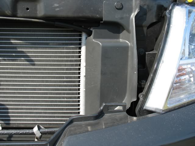

I'll pop the grill off tomorrow and take a picture of how it is blocked on the 2010.. It isnt just the condenser blocking it now.

Alright.. I took a picture for you to see whats going on with the 2010 in addition to the condenser canister, and why Volant doesn't ship the ram air scoop with this particular kit (12540/125406 for 2009-2010s)
Yes, I suppose if you wanted to use the ram air scoop, you could remove or modify that plastic piece and order the 12640/126406 kit for the 05-08s.

RickNY: the 05'+ guys have to pop that cover off for the scoop anyway.

The other reason I think Volant removed the ram air from the 2009-2010 kit is because the headlight design changed in 2009 and where prior to 2009, the left side of the headlight was fairly straight, in 2009, the headlights angle in more, leaving less room.

Before I installed mine (05-08 model) I went to the dealership and checked to see if there was a difference between mine and the 10. I didn't look at the plastic shroud that needs to be removed or altered, but the rest was the same. The accumulator (cylinder) and the tubes were located in the same spots. Yes it blocks most of the ram horn intake.
Your brake lines are different from mine though. Honestly it looks like Volant didn't even look at a newer truck.

Edit: Apparently I am slow at this, noticed your pic you posted after I posted. It is the same shroud.

...The horns are a different story. Sounds like a dying giraffe. I should have listened to the groups experiences and just relocated them at the time. Will be relocating them next week...
^did mine Sun. Extended the wires and fab'd a new mount..

On my 09 I just took the black plastic piece out like you was talking about, and put the ram around the condenser.. The plastic piece comes out easy.. And I agree with the other guys, it's definitely not starving for air.. The volants are very good systems.. As far as trouble with volants on the frontiers I never had 1 problem outta mine at all... I ran volant on my explorer sport also with 0 problems. And both were in very good condition from the factory, high quality, and sturdy..
