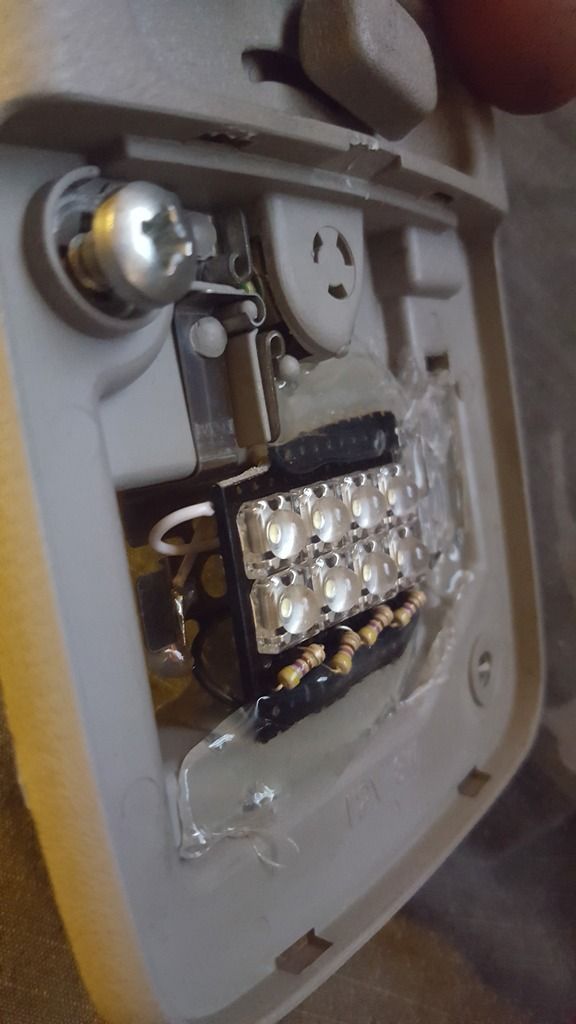

friend came over and grabbed my led stuff for me(couldnt make it to that half of the garage 1 legged.)
forgot to paint before hand but its temp until my new double sided boards get here. and i get the time to cnc some new boards. when i start that again i will be doing tail lights at the same time. just have to figure out the cnc software to do pcb boards.
so much more room just didnt feel the need for more. i will be adding 4-6 more on the next one.
remembered i had a sharpy in my desk.(after both were completed)
plugs into the original plug.
(one of many lost pics)
drivers map light only.
both map lights on
dome light(oem)
led
it is brighter then oem. when i get to adding the center console leds and under seats/pedals doors... then i will be able to see a human hair anywhere in the cab like i can in my fofo.
all lights on.
