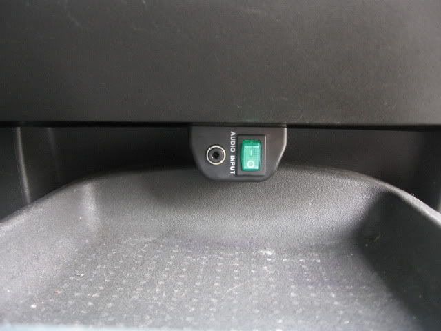

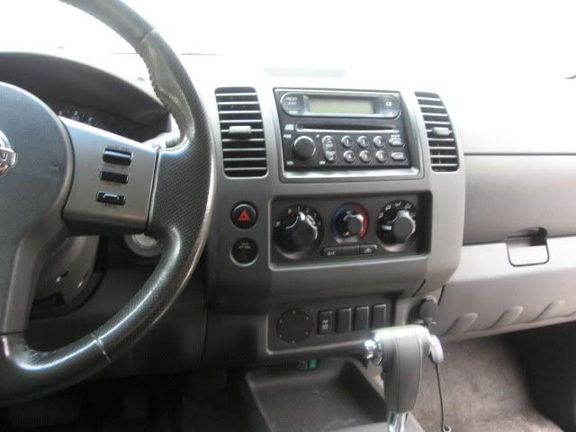

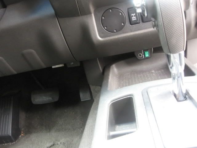

I wanted an aux jack in my 05 NISMO Frontier King Cab, so thats what I did. Very easy to install, took about an hour. The hardest part was deciding where to mount it and place the components.
Here is the finished result:
This is the product that I purchased
Amazon.com: Scosche FM-MOD02 FM Modulator for iPod, Satellite Radio or Portable Music Player:…
I used an ignition switched 12v wire on the radio (green/black wire in upper corner) for the hot wire, and a grounding point on the frame where the radio unit bolts into for the ground. The only thing I needed to buy in additon to the kit was an 18-22 gauge wire tap since I didn't have any.
First impressions are awesome! Sound quality is great and I will definitely give this alot of use as the years come :)

My radio is the stock one without an aux jack. All I do is flip the switch and tune to 87.9. It sends the signal DIRECTLY to the radio through a wire,unlike an FM Transmitter that sends it wirelessly, so it sounds just as good as a CD
