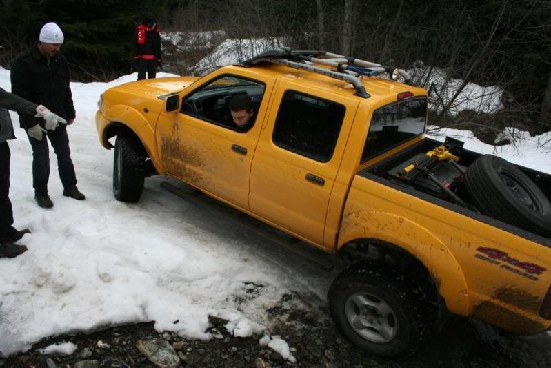

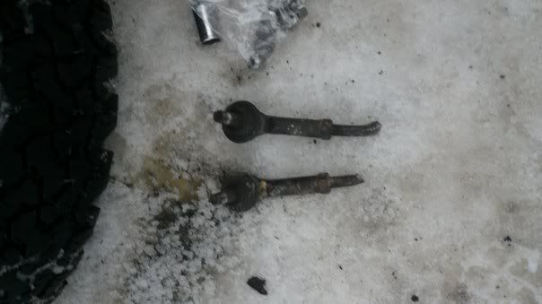

Got it back on and was good to go. In hindsight, I should have left it at that, but it was feeling good, so I decided to keep going and just take it easy. I skipped all of the other side trails we did, and was just going along. We got up to a higher elevation and hit snow, well, more like ice. It was a road with a bunch of cross ditches, not too hard, in and out the other side, lots of *** dragging. Got to one deeper ditch with no traction coming out, turns out it didn’t take much for the weakened tie rod to give out. Snapped it in half this time.
Stuck on this icy hill

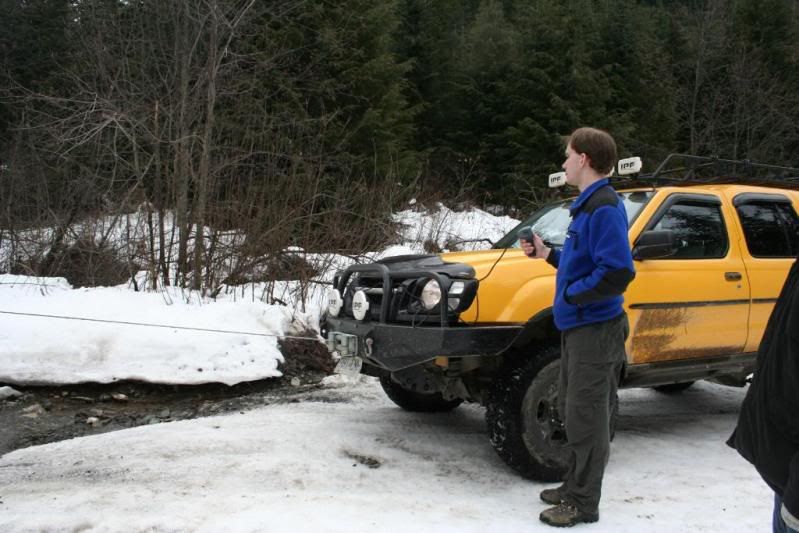

It was the afternoon by now and after thinking it out, one of the guys offered to drive me into town to try to get the part. The rest of the guys said they would stay behind and get my truck off the hill. It was really weird to leave my truck behind for a recovery; here are some of their pics
This is also a good shot of the tire carrier I just built.
And the little bastard:
