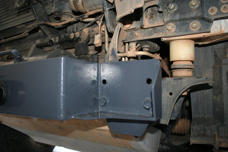

Some pictures of my Winch Mount

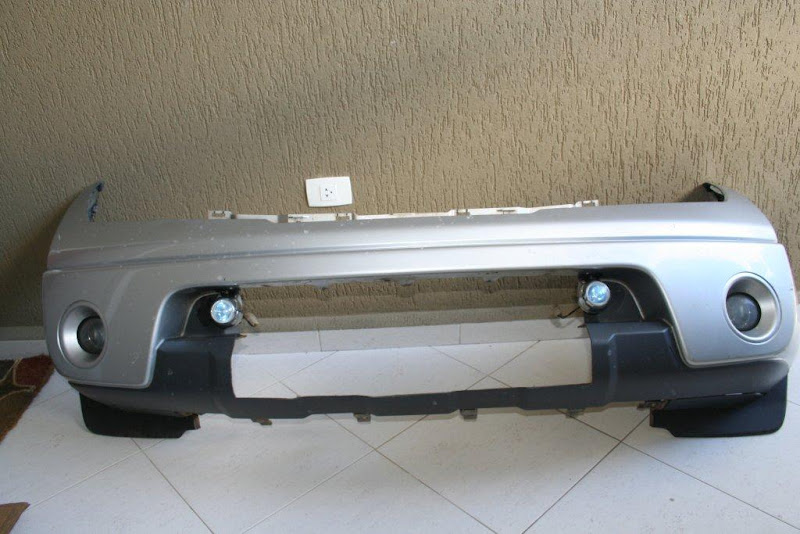

The bumper from de US version is a litle diferent

uuh, just those two little bolts? those are going to fail the first time you use your winch for anything significant.

If you took the tray and intead of bolting it onto the front bumper mounts, used something like the brackets off a front reciever, that should handle most needs.

x2
Factory tow hook points should take main load. Can't tell from the photos if they are actually being used.

I've loaded this set up with 2 stalled 10000lb winches, one on each tow point on my KMA bumper and it's held up. (towing trucks tied off to trees ... yes I was stuck)
BTW the fab work looks really well done.

ever looked at the load rating of a 10.9 metric bolt in 14mm? x4 it will be just fine.
