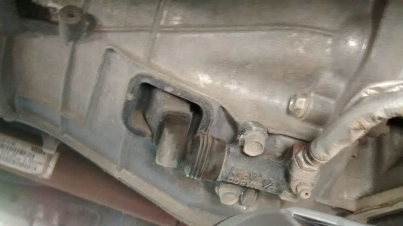

1,190 Posts
1,190 Posts
Oh sorry, you can tell from Nissan4Life pics you don't need to drop the trans. Just remove the clutch slave piston hardware and slide the cover on and reinstall the hardware.
1,211 Posts
I was thinking the tin cover at the front of the bellhousing. That is a different dust cover from the rubber boot on the clutch fork.
