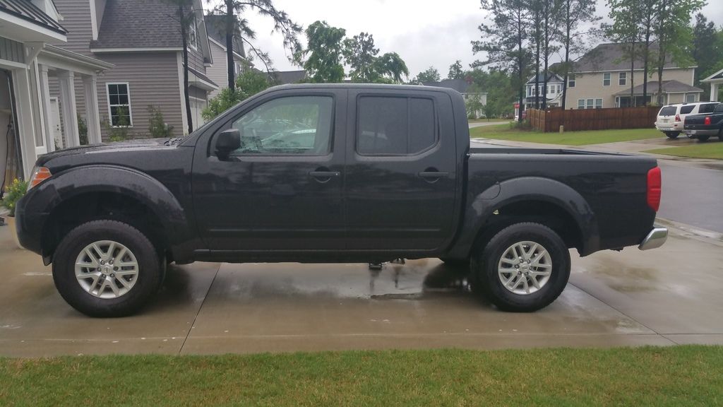

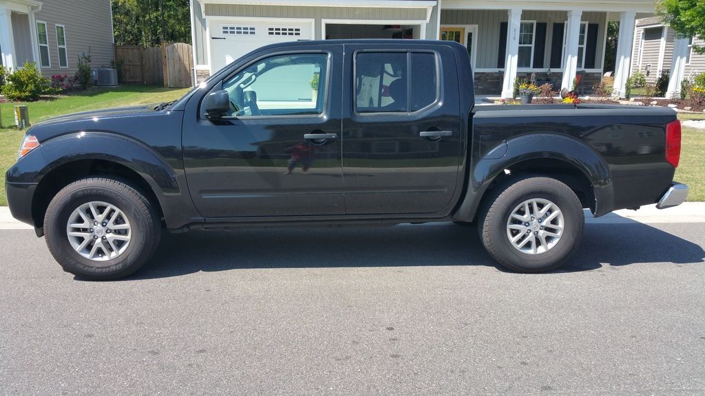

Here is what the truck looked like before the lift
Front spacer going in
Front Spacer complete nothing done to rear (my driveway is a slight incline)

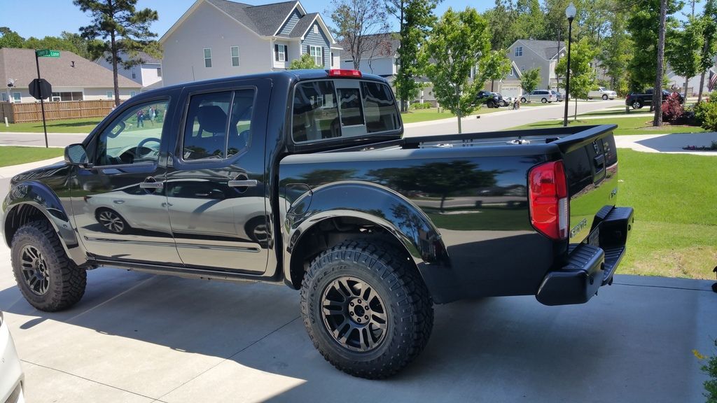

Front and Rear lift complete with stock wheels and tires

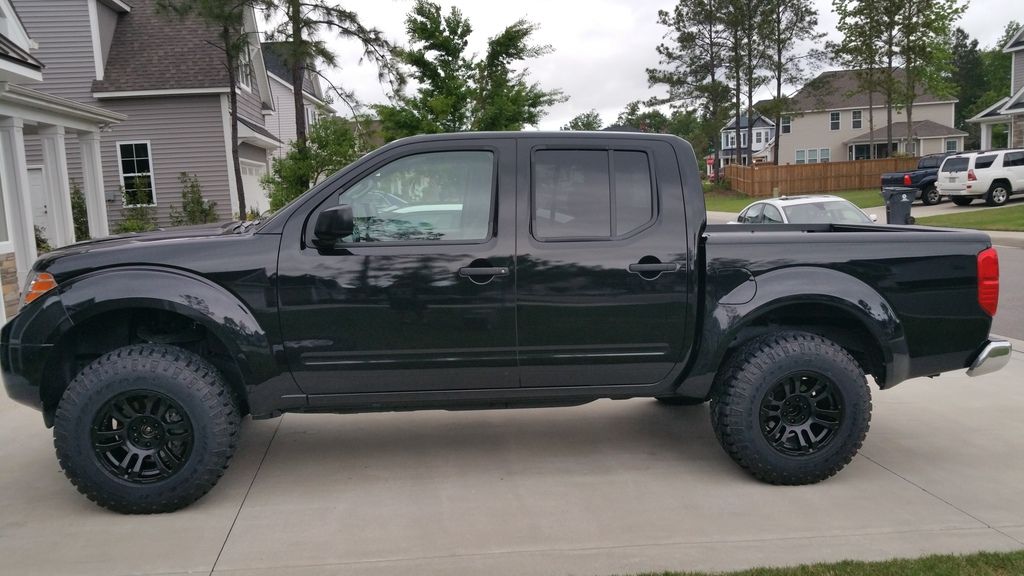

Everything on. 2.5" spacer on front, PRG single AAL in rear, 16" MB TKO wheels, 265/75/16 Goodyear Wrangler Duratrac tires

Looks good, how does the spacer ride feel, everything else still stock right, get it from PRG directly?

I love the way the truck sits and rides now. I feel like this height is how they should come from the factory and even the slight width i gained from the offset on the wheel makes the truck feel more "planted." The spacer is just some cheap one from ebay. The AAL in the rear is straight from PRG and I removed the overload. Overall very happy with the setup.

HA! Yeah I get that. I'd say just do it. You'll be happy with the results. The install is pretty easy too. The most difficult part for me was taking off the lower nut and bolt on the rear shocks. Those damn bolts are on there tight!! I tried almost everything on them. Air tools didn't work, soaking it in PB blaster for hours didn't work, breaker bar didn't work. Only thing I didn't try was heat. I finally had to take it to a friends shop that has more powerful tools than mine and he was able to get it loose no problem. Very demoralizing when I spent 4 hours trying to get it off and he got it loose in 2 minutes!! Other than that the install was smooth and easy and I was doing it by myself.

I'm not a big chrome guy, so I took some time over the weekend to black out the rear bumper. Good ol plasti dip with glossifier on top did the trick. Next up is the front grille. I've used plasti dip before on the front grilles of my Xterra's and was never really pleased with the results. So with the Frontier, I've decided that I am going to take it to a professional and have it painted. Hopefully I'll get that knocked out in the next couple of weeks. I'm still undecided on whether I am de-badging the rear or plasti dipping the chrome badges....

On my last Frontier I debadged the rear. However, the Nissan logo on the tailgate has holes to fasten it though, so it was kinda ugly and I always regretted doing it...
This time I decided to PlastiDip them. Keeps the anti-chrome theme and makes it look more rugged. This way they still announce that I paid more for the Pro-4X package but not so flashy as chrome. It was one of the first things I did. I even got black lug nuts and turned the tires around so the white lettering doesn't show, only the black of the tire. The only chrome left is some small trim pieces in the cab. (Steering wheel, shifter, climate control and radio knobs...)
Pictures aren't that great but all my friends say it looks like it came from the factory that way. Can't even tell it's DIY.
I also did the front badge but I might use some spray bed liner because I know a rock will chip it at some point and the PlastiDip can't handle impact from rocks like that.
