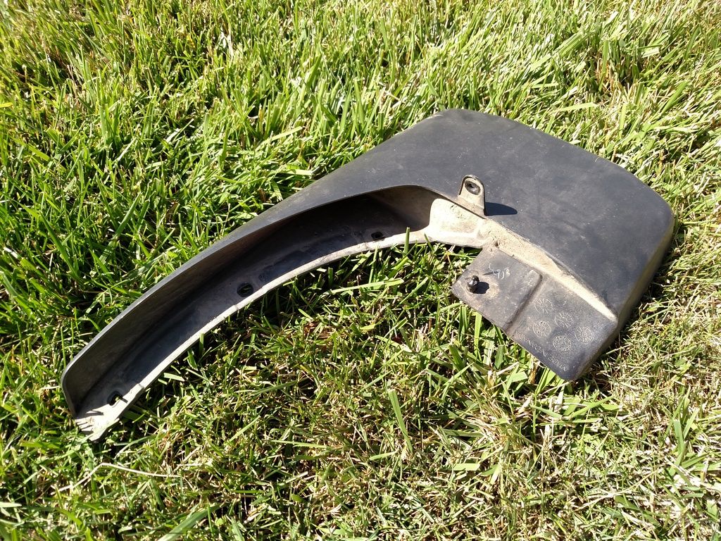

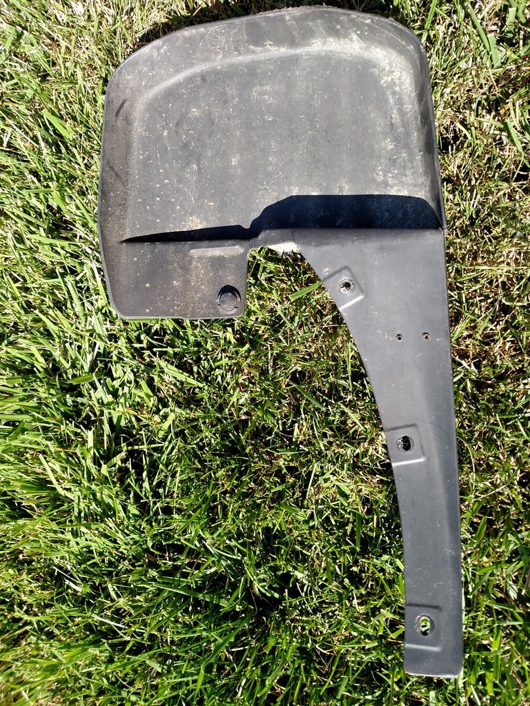

Alright, was feeling like a nice guy that wanted to be extra helpful this morning so here ya go.
Mud flaps (edit: rear mud flaps) take 4 screws and one push pin fastener.
See pictures below.
3 screws up the side, push pin shown to the left on it's own tab:
1 screw through perpendicular tab to secure at bottom:

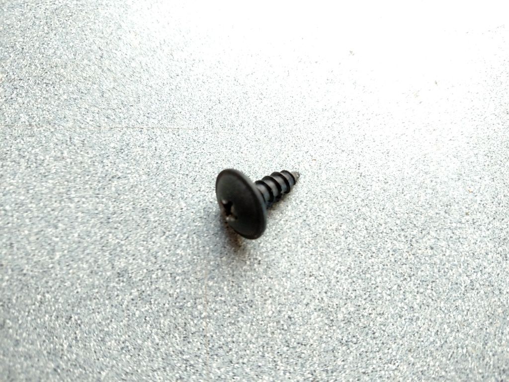

And the actual type of screw used, it's roughly 1/2" long and a self threading truss head screw:

For the record, that is a rear mud flap shown.
I just went out and looked at the fronts.
travhale is correct, there is no push pin fastener on the fronts.
The fronts are held on by 4 truss head screws only like the image I posted above.

Installed my used mudflaps (sans OEM mounting hardware) today.
Fronts went on easiest as the screws holding the rearward fender liner on were simply removed and reused/screwed back in for a secure fit.
Rears required removing some factory installed flat clips with a putty knife from the 'square holes' in the fender/wheelwell lip as well as the lower mounting point. I didn't see how I could use factory style screws (like above w/o a nut), so I used my recently delivered Chinese push pin fasteners for ALL the mounting points. Not sure this style of attachment will pass my "kicking slush off" test this Winter.
