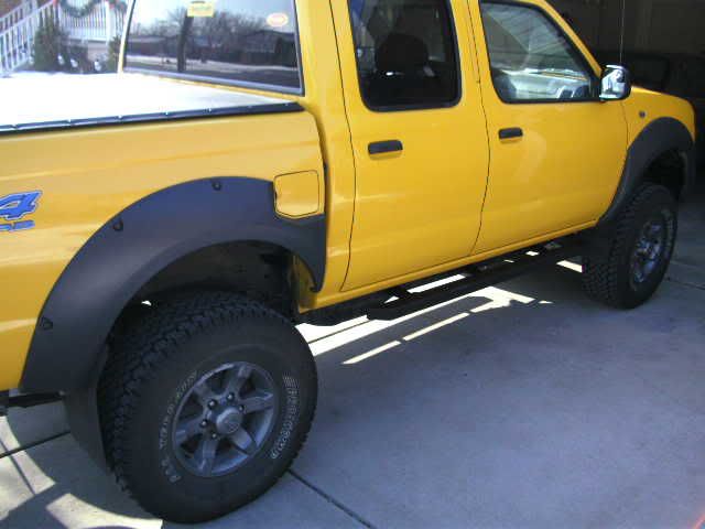

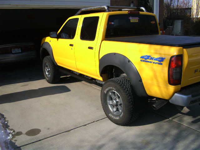

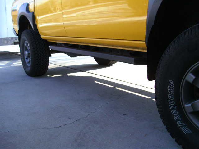

I bought these sliders used off of the local classifieds for an xterra. They are a little short because of it, but for $100, I cant complain nor not get them. I had to grind off one of the mounting brackets and weld it back on to match the stock frontier slider mounting holes. After lots of sanding and grinding, I put several coats of a metal primer, then three coats of a spray on bed liner, all in black. I then let them cure for a full week before bolting them on thanks to the cold weather. I think they look a little funny because of the body lift I have, but it would only be for looks to move them up. i am not worried about the look of them being that low. Enjoy.

I had to grind off one of the mounting brackets and weld it back on to match the stock frontier slider mounting holes. ]
Stock holes? Frame or body(pinch weld)? I hope they're on the frame.
Look great nonetheless.... great price too! :goodjob:
:laugh: dude look at the pics, hes no idiot they are bolted to the frame rails and clearly nothing on the pinch welds
Yes, they are bolted in the factory holes on the frame. I have only used two of the three brackets because the supports in the middle line up with holes in the frame that have no nut behind them. I am going to throw some bolts in the middle support all the way through the frame. With just the two supports bolted, they hold very well. I can stand and even jump on the sliders and they feel as if they were the frame itself.
