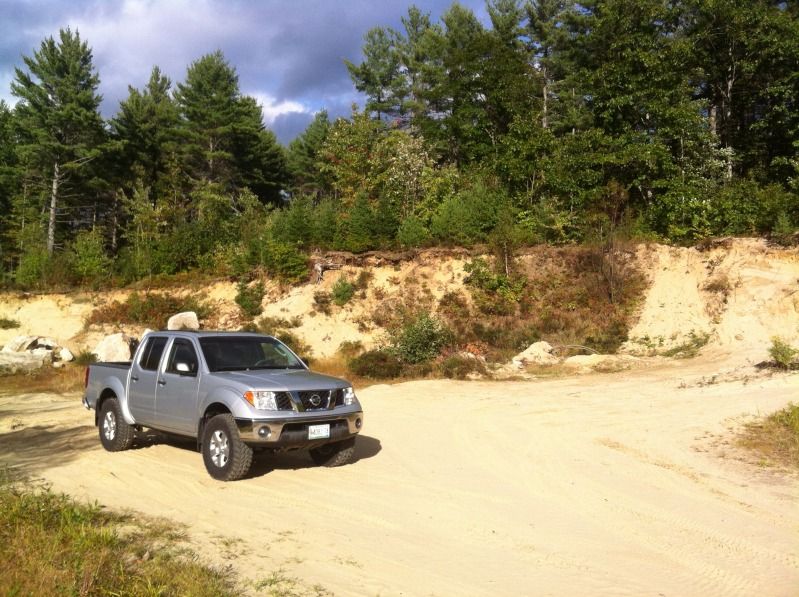

Out in a sand pit doing some target shooting.
I also took care of the peeling paint on the roof.
http://www.clubfrontier.org/forums/f23/repainted-roof-gutters-lots-pics-83745/
