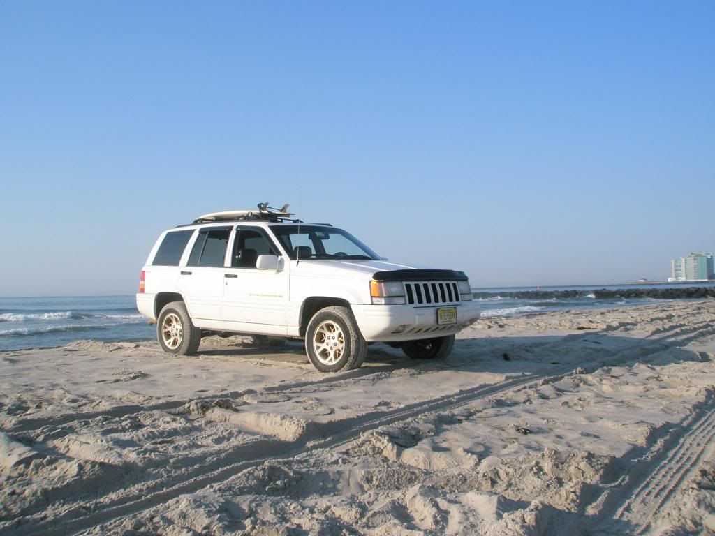

I later sold the bike to buy my first truck, a 1998 Jeep Grand Cherokee Limited (ZJ).
After modding. Never got to lift it. Never should have bought the Jeep as a 17 year old kid. I spent my entire savings on it and when the transfer case went out on it a month after I had it I soon was in debt with my parents for $1800.

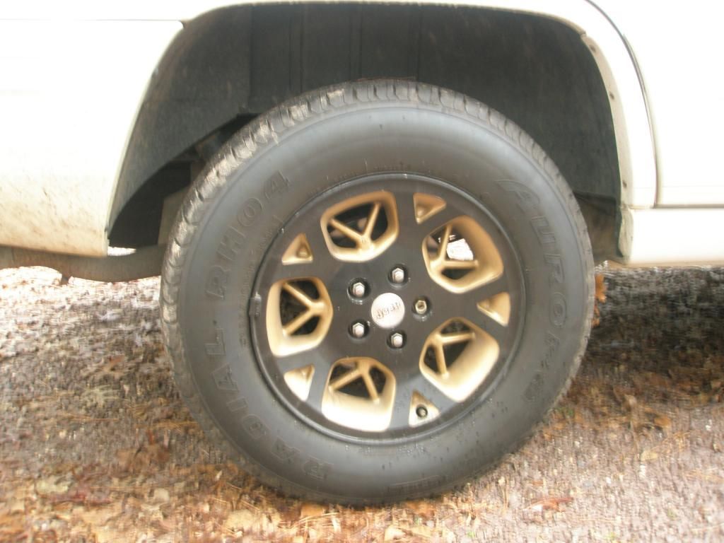

I was so proud of these wheels.

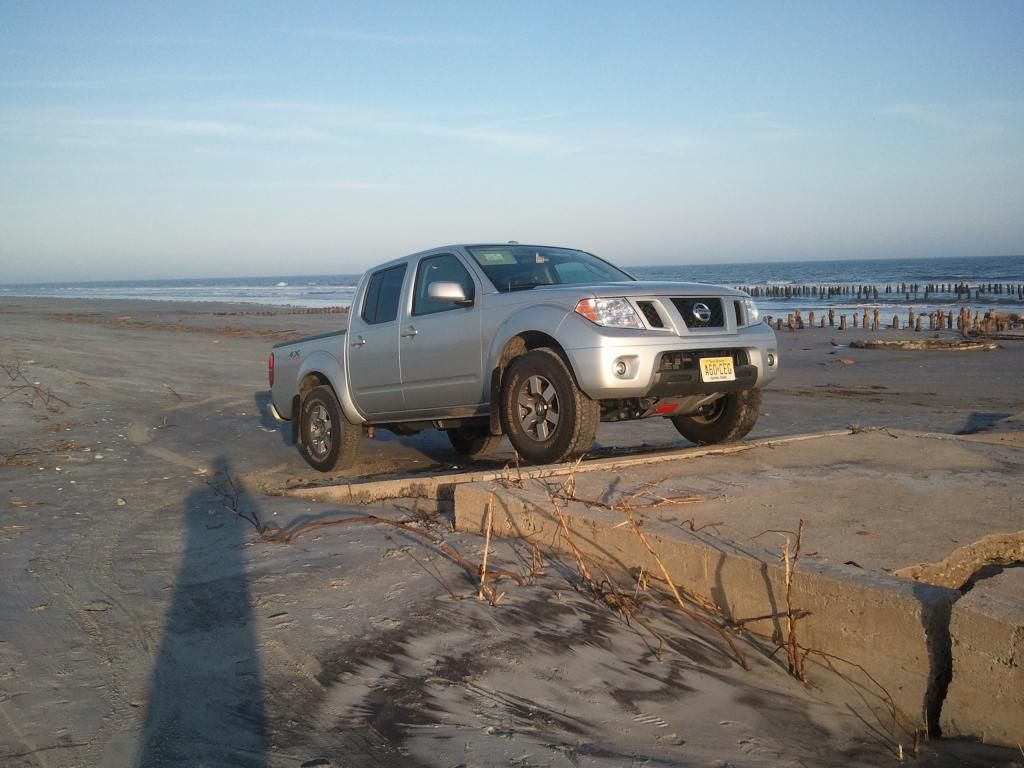

Hurricane Sandy washed up the foundation of an old Coast Guard station.

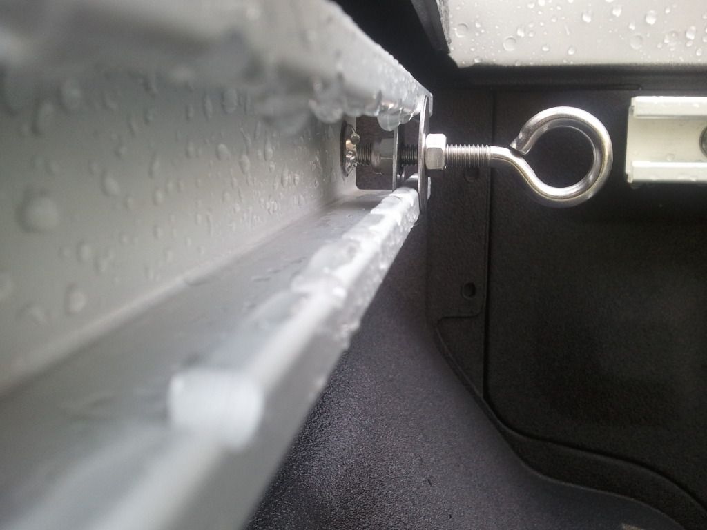

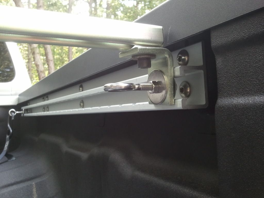

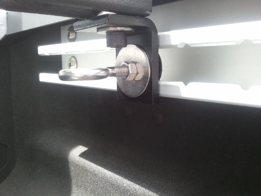

My version of custom tie downs and surfboard/snowboard rack.

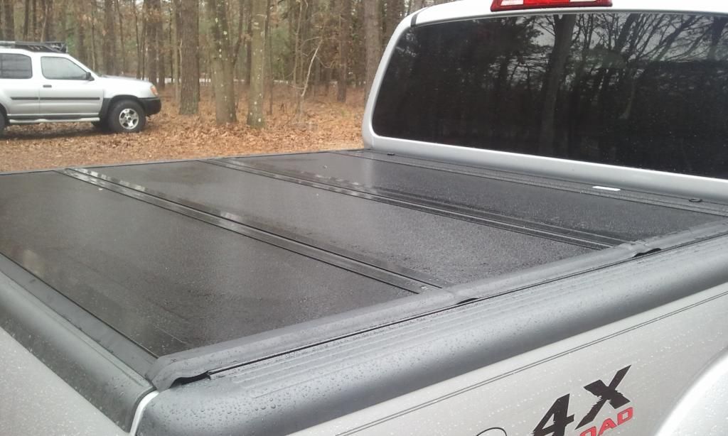

Bakflip G2:

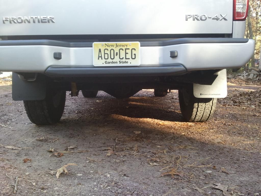

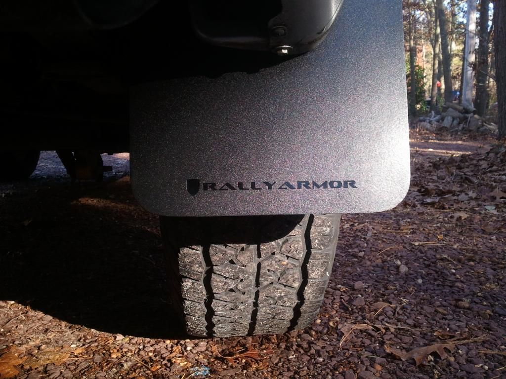

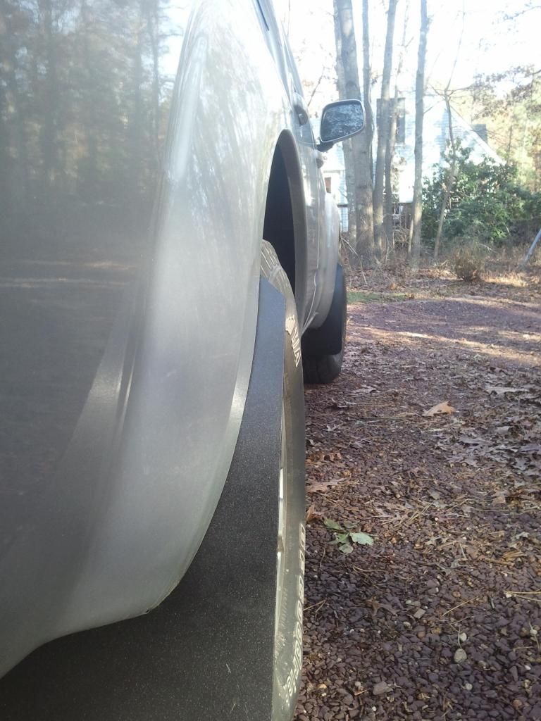

Rally Armour Mud Flaps

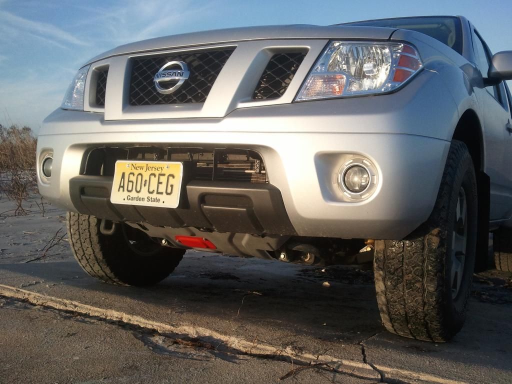

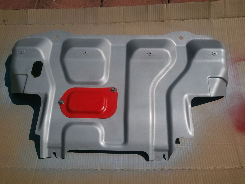

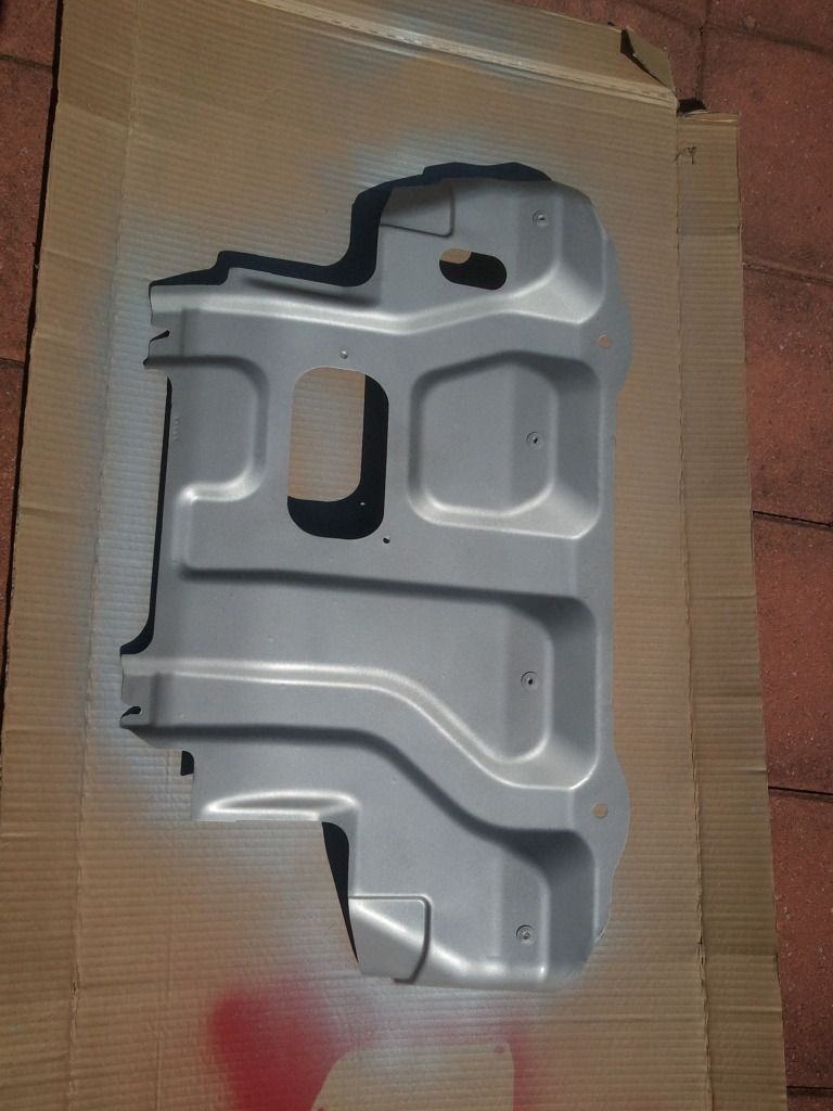

Painted Skid

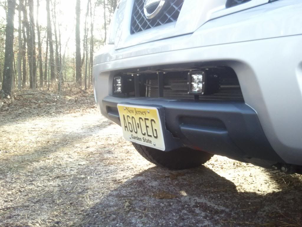

Xoskel Bumper Mouth Light Bracket. Runs approx. $60
I got the same Rigid Lights but I rotated my cover so that the words were correct. Not upside down. To me thats a great location because it doesn't really stick out. Nice Ride.

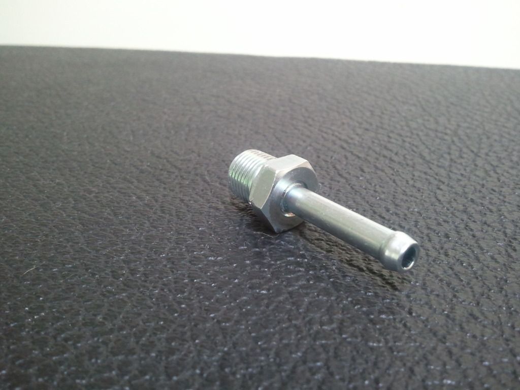

Axle Vent Mod
What do I need??
Nissan Part #:38323-C601A, Hose (I used 1/4"), and a filter (I used a cheapo chain saw filter) and hose clamps. Got my Nissan part here: http://www.courtesyparts.com/breathr-co-p-587494.html
You can't see it because there's a hose in the way... but this is where it goes.
Where this OEM breather was.
The stock breather gets clogged with gunk and causes the axle to build pressure, either positive or negative. Both are bad... It will cause premature axle seal failure, and can cause your axle to become contaminated with whatever water you're fording... Change it out and move it up.
I put mine behind the tail light. Took 7' of hose.
Don't forget to leave a bit of slack for axle movement. Just go by what the brake hose has, if Nissan says it has enough movement, so will your new vent hose.
Done!

Great start so far. How long have you been running the new flaps and have they helped?
edit: and did you get the basic or urethane universals?
Been running them for about 3-4 months now. They're pretty durable. I had to trim the fronts a lot more than I wanted to though and they still rub with 265/75/16 Rugged Trails. The backs went on without any trimming and they look great. I made sure the flaps hung over the edges of the fenders by almost 2" and it definitely helped with the rocks getting kicked up. I rarely hear the familiar "ping" of stones on the rocker panels.
When I switch to 285's I might try to modify the stock flaps with some trimming, not really sure. I'm just worried about how the fronts will rub.
Ok, I think I may give the basic plus's a try. My rear bumper is so torn up after just 10 months and just noticed 2 nice sized chips on my driver rear fender. So some touch up paint and flaps are in my near future. Your pics are the first rally's I have seen so far and looks good! Could you maybe grab side pics so I can see clearance?
Man, I never saw this till now!
Looks great! :fantastic:
I forgot to tell you, I have the basic ones, like $25.

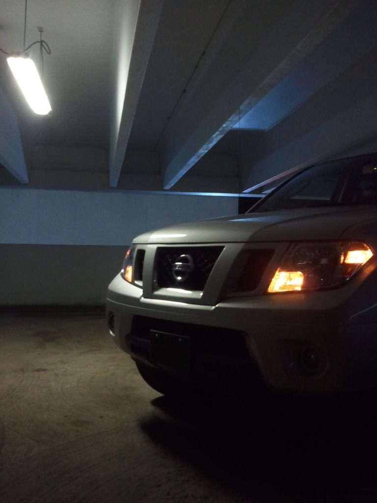

LED Conversion
Decided to convert to LEDs. Not all at once but most of them for now.
It took me a lot of searching and ordering wrong parts before I figured out what the heck I needed, so hopefully this will save someone some time, effort, and money.

Left is stock halogen, right is 5000k High Power LED
[/URL][/IMG]
Update! Installed the rear flashers, reverse LEDs, and load resistors. Night shots to come! Here's a before and after video, no more hyperflash.
