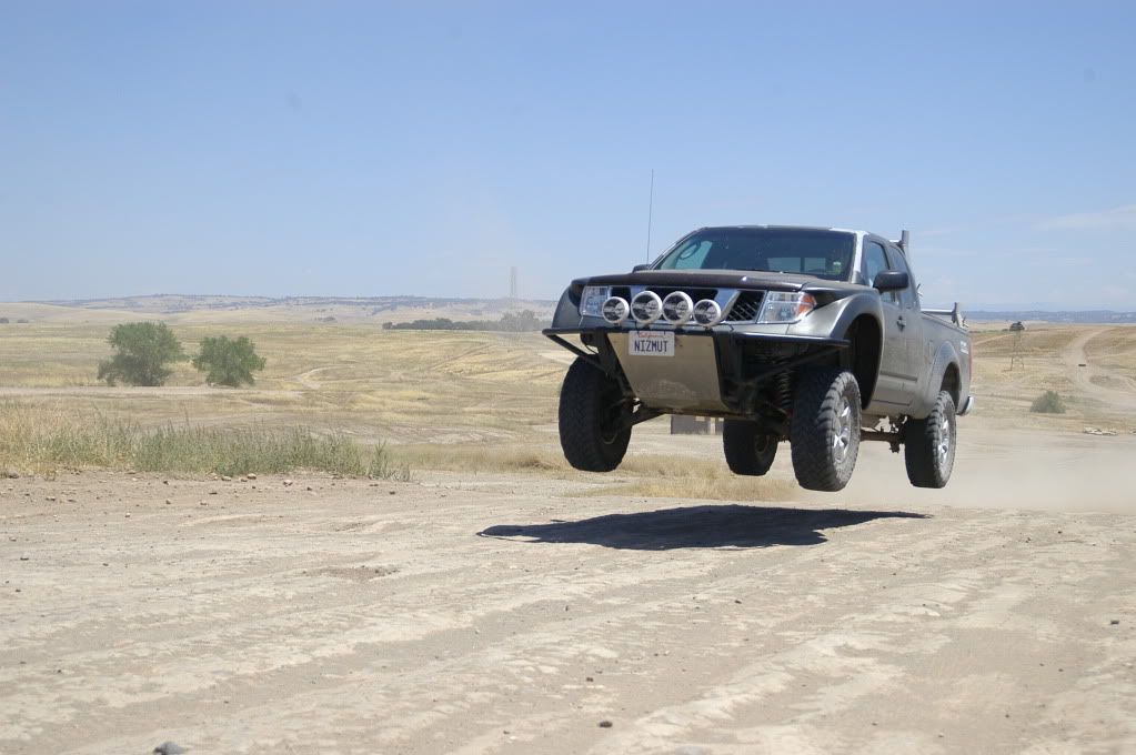

3,556 Posts
My shocks have around 20k on them and have never been touched. Then again they where valved for my truck by someone who knows how I drive
Thanks Greg
882 Posts
Discussion Starter · #16 ·
^^^ HOLY [email protected]#K. Dude that's awesome(pic). I would love to do that in my truck. Thanks for the info on the longevity.
