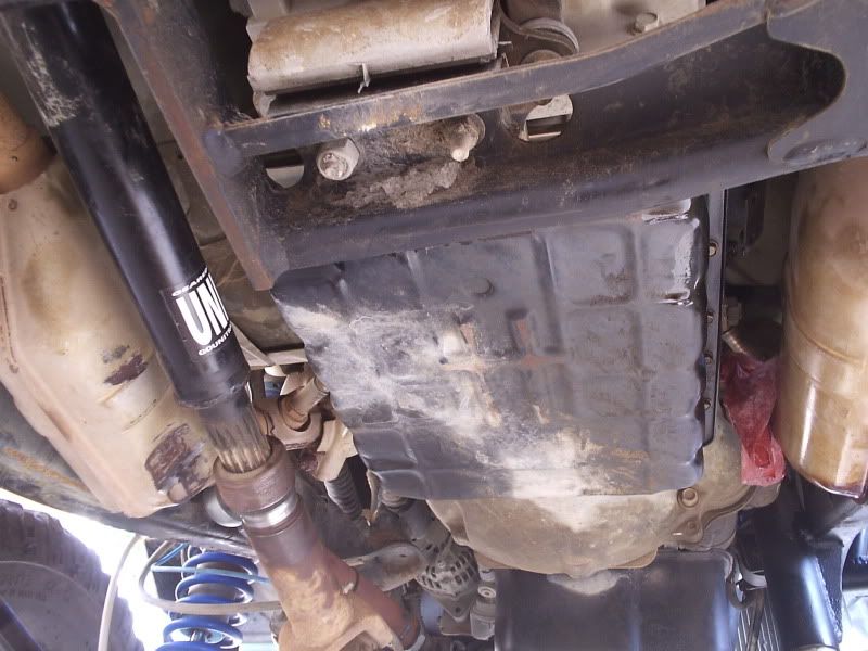

hi, i have a four cylinder so my only cat is one the left.these trucks are designed to have a driver's side pumpkin, there is no room for the driveshaft in between the cat and the tranny on the passenger side, unless you want a retardedly tall truck. also, you would have to run a divorced case and there would be a lot of fabrication involved.
you can pick up a 4x4 tranny and tcase that will bolt right in with an addition of a crossmember and all you would have to do is figure out what you want to run for a front axle. a full width d44 from an 80's wagoneer works great. unfortunately, typing it out isn't as easy as putting it together, but forget about toyota stuff up front.
