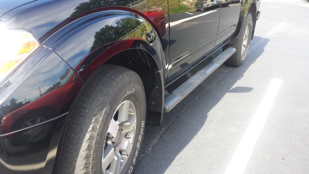

A few days ago I was stopped at the exit of a shopping center waiting to make a left and a 90s Plymouth Voyager attempted to enter the shopping center turning right, but was unsuccessful in negotiating the turn.
No one was hurt and the driver had insurance so from that prospective it turned out fine.

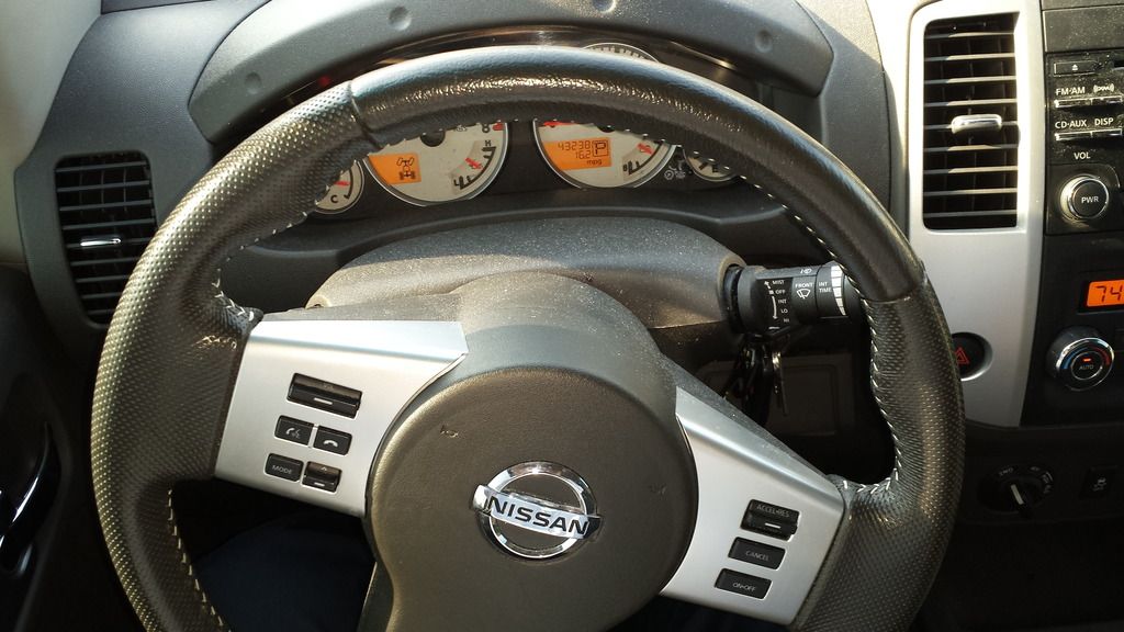

Some contact was made with the LF wheel/tire, but I don’t think the brunt of the impact was there, but the steering wheel is off when driving straight (above), and even by my naked eye, I can tell the left wheel has some slight negative camber and I have a toe out condition. It is not drastic but it is visible.

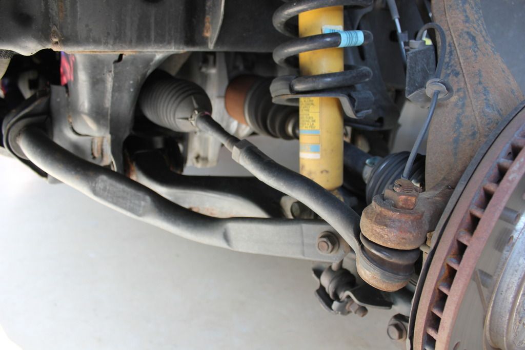

I took my tire off over the weekend, and yep, there's a tie rod attached :) (I wouldn't know a bent one if it hit me in the head).
and I took it in for an estimate yesterday. They will use all Nissan OEM parts so I'm happy about that. He couldn't comment or estimate on the suspension until they get the wheel off in the shop.

Since you say the tire looks like it has negative camber and you need to turn the steering wheel to the right to get the truck to go straight, I would suspect that something with the upper control arm is amiss. When you get the vehicle repaired, you may want to check that area to see if they replaced the upper or straightened out the frame in that area. (Or, just ask them what they found)

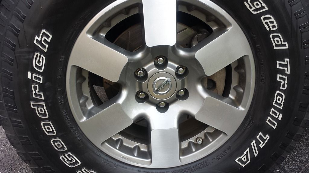

Just updating and closing out this thread I received the truck back from the shop a week ago. Pretty happy with the results.
The wheel was refinished.

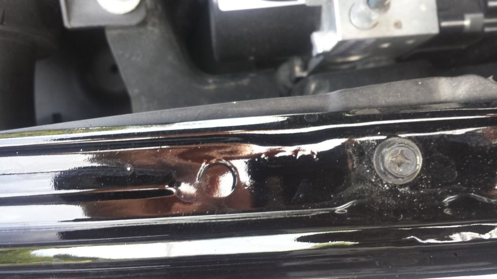

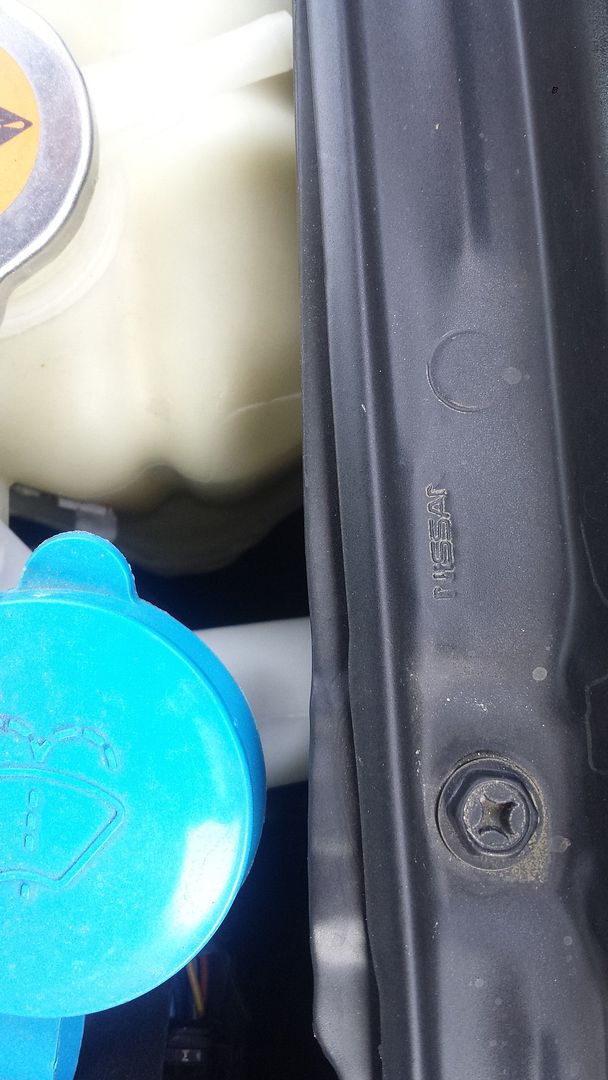

From the hood, here is a pic of the stock passenger fender, flat black and you can read the Nissan stamp.
Drivers fender, gloss black and the paint is thick and it almost entirely fills in the Nissan stamp.
Anyone will be able to tell the fender was replaced/painted by opening the hood but that doesn't bother me as I'm guessing the paint is twice as thick as original (and I plan on keeping the truck long enough that it won't make much difference in resale value). Also the texture of spray pattern matches extremely well with the rest of the paint.
