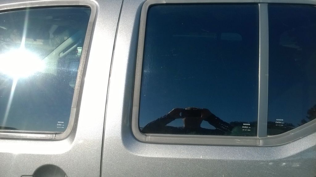

I believe getting my windows tinted would be considered to be my first mod. I had my windows tinted to 32% all the way around at a reputable tint shop.

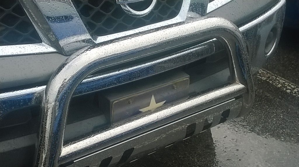

For Christmas last year I got a bull bar, Nerf bars, and a new stereo! My wife asked me what color I wanted for the bars; she thought I wanted to black everything out, but I didn't think it would look good against the gray. I told her chrome or polished steel. Lo and behold, the next week I had some big boxes to open! The bull bar installation was easy enough. My frontier was equipped with only one tow hook, so I removed it along with one of the pieces of plastic air dam. The brackets attached to the tow hook mount points, and the bar bolted directly onto the brackets. The only downside is that it covers up most of my Bonny Blue Flag.

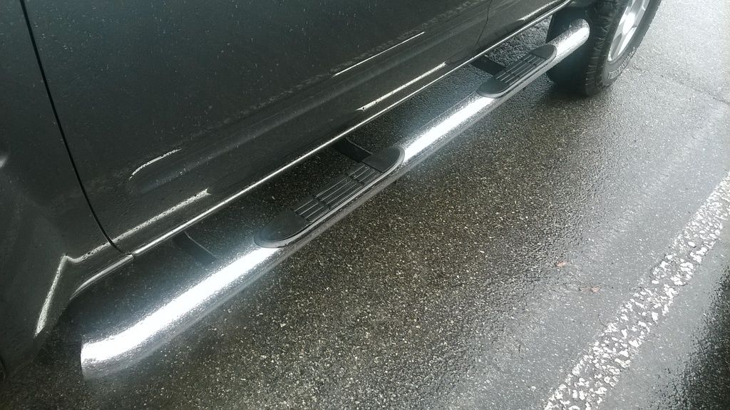

The nerf bars were easy to mount too. Each one bolted to the frame utilizing the points used for factory bars if purchased.

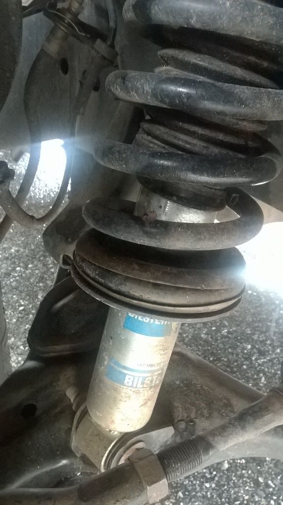

In February, I started my lift. I ordered the eBay 3" spacers, cloned Total Chaos UCAs, and cam bolts for the front and 2" blocks for the back. I ordered Bilstein 5100s from Amazon, and ProComp ES 9000s, extended front brake lines, and Fabtech single AALs from Performance Lifts.
After receiving everything, that was when the fun began. I figured it would take a full day to do everything, so I gave myself two and a half, starting on a Friday afternoon since I was inexperienced with this type of job. It took me four with all the problems I had. My wife was pretty aggravated with my driving her Durango to work with my frontier partially on jackstands in the driveway. So, I took the front end apart, and installed the Bilsteins set at 1" for a total of four inches of lift. I originally set the Bilsteins for 2", but there seemed to be too much coil bucket contact, even with the aftermarket UCAs.
Bilsteins installed:

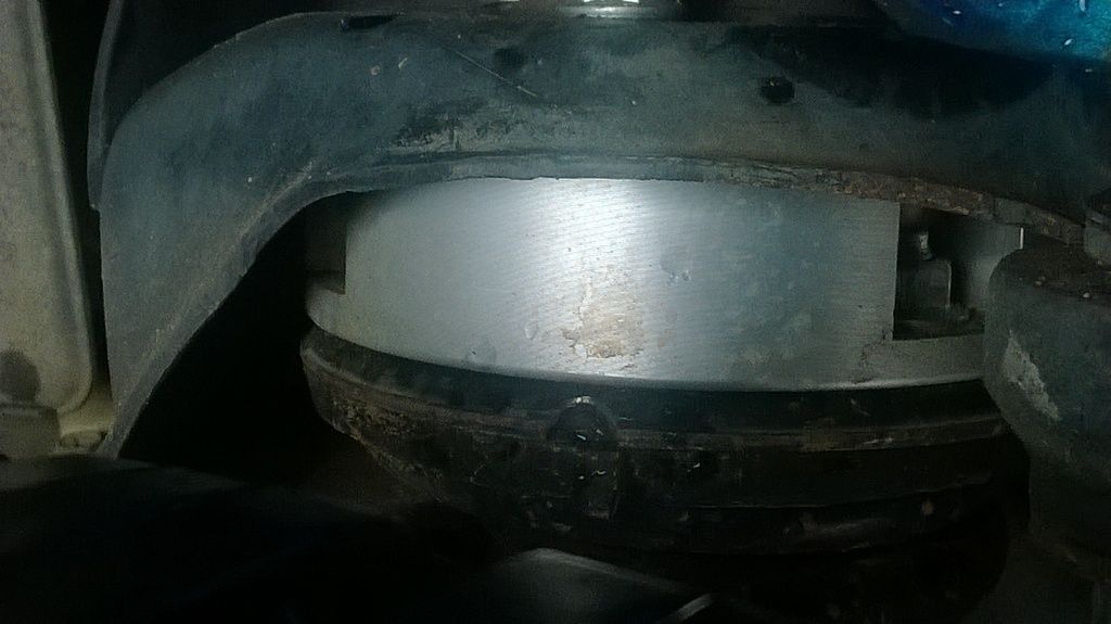

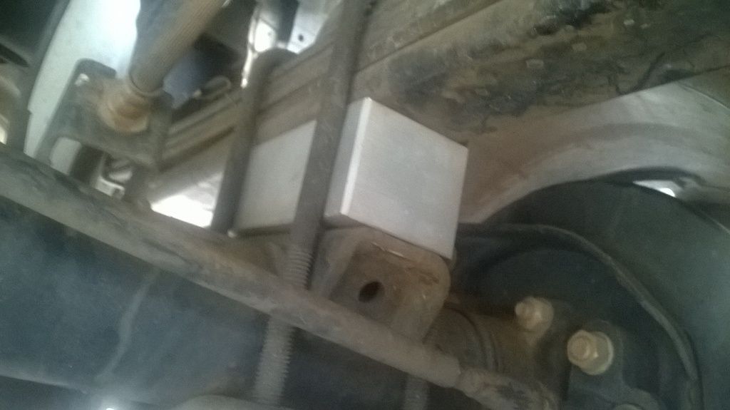

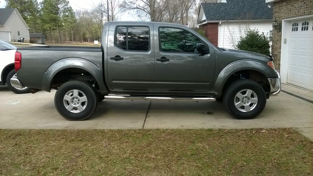

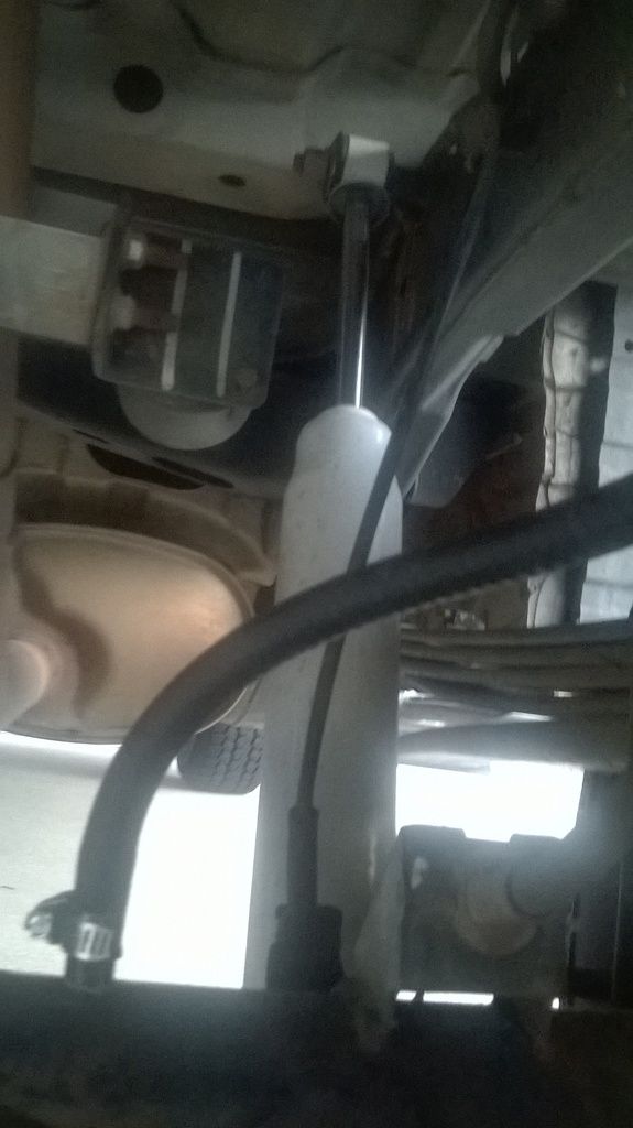

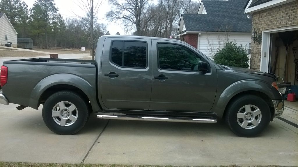

On the fourth day was when I finally got to lifting the rear; I ended up staying home from work to do it, and it only took a few hours. So, I added the 1.5" AAL, and 2" lift blocks to the rear, and installed the ES9000s, got everything tightened down, and took it to have the front end aligned. I then proceeded to check the difference in rake between the front and rear. Before I started, there was a 1.5" difference between the front and back. After driving around and giving everything a chance to settle, I measured again. I estimated that the 1.5" would be lessened to 1"... Wrong! The rake actually increased to about 2.5".
ES9000s Installed:
Lift Block and AAL Installed:
Before Lift:
After Lift:

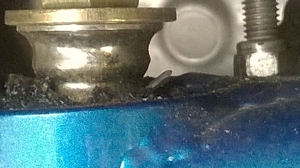

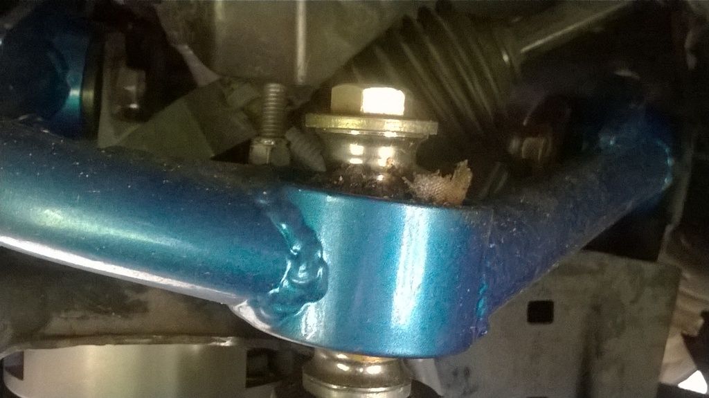

At some point I believe I am going to have to do a T Swap in order to adjust the Bilsteins up another inch, or, replace the crappy bearings in the UCAs and grind down the coil bucket to increase droop. I do not want to bring the back down in order to do this. @glamisdude suggested the T Swap, and I believe I agree... Just takes time to gather up the stuff. Hopefully the bearings will hold out.
PFTE extruding from UCA spherical bearings:

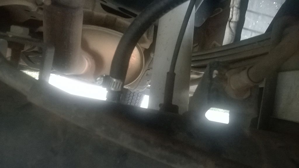

Next thing, and the most recent mod I've done is the vent mod to my rear differential. I had to get the barb from the local Toyota dealership for about $6.
Rear Axle Vent Hose:
I don't have any photos of the work in progress; I didn't think of taking any at the time. I hadn't even thought of posting a build thread. I'll try to take more pics of future mods while in work and post them.

Thanks. She even asked if I wanted a black powder coated one or steel/chrome. I figured the steel would look better with the gray.

I then proceeded to remove the UCA. I lifted up on the spindle with a jack to relieve the pressure from the UCA, while strapping up the spindle with a bungee cord. Before installing the Tuff Country UCAs, I went ahead and packed them with grease while assembling them. So, I removed the UCA and went ahead an bolted on the new one, and went ahead and attached the spindle to it temporarily.
