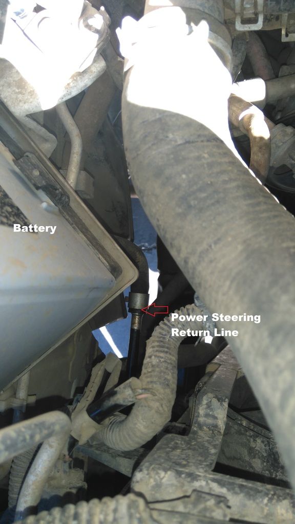

3) Remove low pressure return line
- If looking in from the top near the battery you should see a small hose (fuel line size) hose clamped to a metal nipple coming from the bumper area right above the passenger side frame rail
View looking down into engine bay:

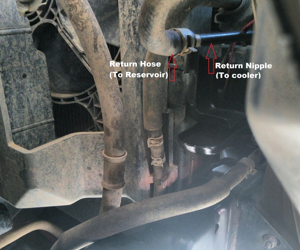

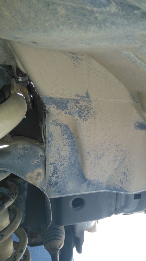

- It is easiest to remove the hose clamp and do all the work from inside the fender by bending up the fender liner and reaching in with a set of pliers. I used some long reach needle nose and that seemed to work well. If you are a larger person, you may want to remove the tire on this side.
Fender liner:
Lift up to see this:
- Once the the clamp is slid back on the hose setup your catch cup just below the the nipple. There is a nice spot just below it that should hold the cup in place.
- Setup your hose and primary oil catch in this area
- Place some rags below this area as I had some spillage during this next step. Also remove the power steering fluid reservoir cap at this time.
- Carefully remove the hose from the nipple and place it in the catch cup; the cup should collect all the fluid in the reservoir. Meanwhile, slide your bit of hose over the nipple to collect the small amount dripping from it.
