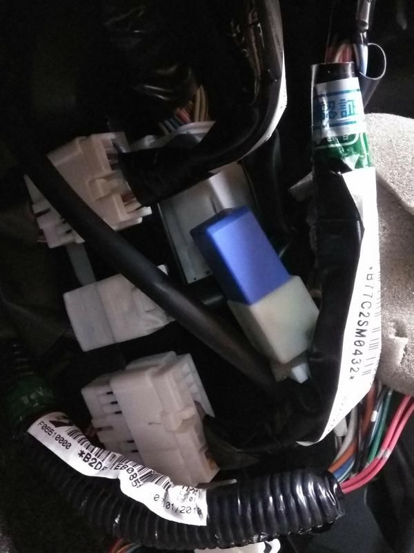

Hi all. I recently noticed that I have been having an intermittent flickering of the lights on my dash when toggling back and forth between the driving lights and headlights. It does not do it every time...only sometimes. I have never picked up on this before so I figured I would run it by you all to see if you had any suggestions/thoughts as to why this might be occurring. I recently installed a new battery, and checked that the connections were snug. I also recently pulled out the blower motor to make sure there wasn't any debris hiding in there after changing the cabin filters. Any thoughts you have would be much appreciated.

So a quick update. The clicking sound I am hearing is coming from the blue...I'm guessing it's a relay when I switch the driving lights on and off. It is located near the passenger side door behind the kick panel. Can someone help identify what that is and is it something anyone knows a part number for by chance if the clicking indicates it needs to be replaced?

Driving lights are the corner marker lights turned on without the headlights. The reason why I showed the picture of the trailer lights relay is because that is where the loud obnoxious click sound comes from.
Kurt. I did disconnect the tow harness and the clicking sound is gone. That is why I would have to think there might be something going on it with the harness or one of the relays...but not sure how to be sure of what it is.

Relays do click when they work. May just be operating normally. You can test it by applying voltage to the input terminals and checking for continuity across the output terminals. Or you can just replace it; small relays like that one are cheap.
Yeah, I have read that relays do click, but this seems so much louder than normal. I never recall, in the two and a half years I have owned the truck, being able to hear the click this loud. An occasional flickering of the headlights also seems to happen in conjunction with the "clicking" when it is really cold outside as I toggle back and forth on the light switch. If it was just the clicking, I wouldn't be on this wild goose chase. The occasional flickering of the headlights is what has me more concerned.
I tested the relay terminals for continuity with my multimeter and all wires seemed to check out. :-?
