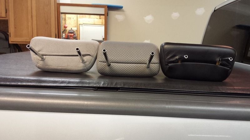

I tried the headrests from the Nissans I own.
B13 Sentra SER do not fit.

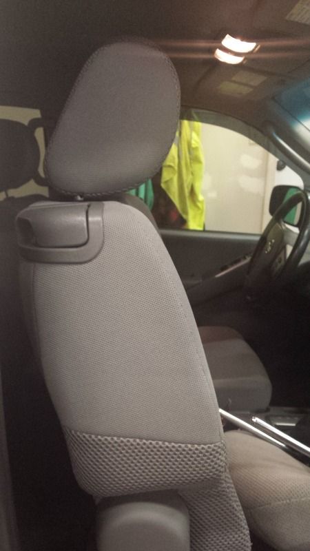

A32 Maxima/I30 fronts do not fit. Rears from an I30 do fit. They are much smaller and have 2 settings. They will give you a a lot more room.

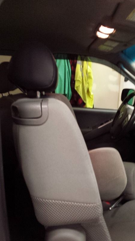

L31 Altima fits. They have multiple settings like the D40. They will give you a little extra room.

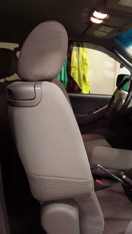

Original:
Altima:
I30 rear:
All 3:
I also just realized the headrests on my truck (2007 SE) are nothing like these others posted. Nissan must have changed them at some point.
