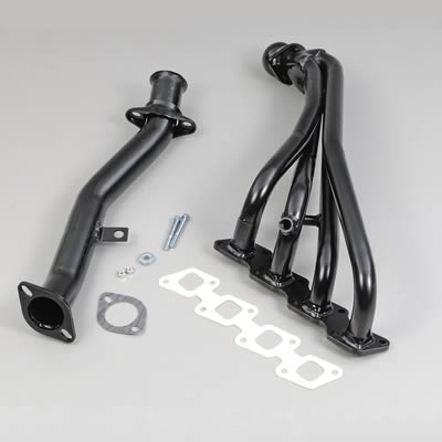

PaceSetter Performance 70-1196 - PaceSetter Headers - Overview - SummitRacing.com
They say that these aren't very good quality, and wear down pretty fast. But I'm planning to get these on down the road because its the only ones for auto i've found.
if you can get the header cheap enough, i would suggest you try it.
Hmm, that looks like a 4-1 header, good for high end output. Your link led me to look at Summit again and I found this.
A 4-2-1 header should be better at low and mid range power. It's ceramic coated too. It's almost as expensive as what I've seen the DC Sports header listed for the 240SX though.
At the Acura Integra forum I used to post at there were quite a few claims that the Pace Setter headers performed worse than the stock manifold as well as being poorly made.

just saw this on pacesetters website. it says its only for manual transmission. They are the same product codes as the ones on summit.
Frontier, 2WD, 5-spd 98-00 2.4L 1-1/2" 2-1/2" 1, 3, 6 G7288 70-1196 72C1196
Frontier, 4WD, 5-spd 98-00 2.4L 1-1/2" 2-1/2" 1, 3, 6 G7288 70-1199 72C1199
Pacesetter Performance Products - Exhaust Parts for Trucks and Cars
Then again on summit, it has this:
Standard Transmission Column Shift No
Standard Transmission Floor Shift Yes
Automatic Transmission Column Shift Yes
Automatic Transmission Floor Shift Yes

im eventually going to try the obx long tube one. looks like a better piece than the paceshitter.
OBX Header 91-94 Nissan 240SX 16V KA24DE S13 Manifold : eBay Motors (item 190369682218 end time May-01-10 12:33:22 PDT)
thats another option.. but you want the long tube one. you're after the scavenging effect.
will all those work with our frontiers? not just the 240sx?
it looks like it would work. however no one has tried it.
if i can get enough money to spend on one, i would do it just to check clearance/fitment.
the pipe extension down thing to the stock exhaust might be different
