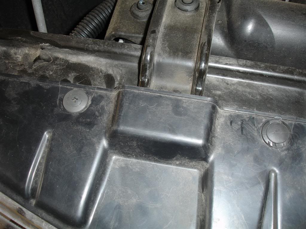

Pop the hood and locate the small round "button" clips at the top of the grill holding the top portion on. On my 2006 there are 6 of these. I have to note that there were two different kinds of these clips both work essentially the same, why I don't know, ask Nissan.
Showing the two different clips still holding the grill on:
Showing the two different clips removed:
As you can see, the center part needs to be popped up/out before the outer part can decompress and be removed. Shown above the one on the left was the pry up kind and the one on the right is the threaded/screw out kind. Get the center part out and then remove the outer retaining portion for all six of these.

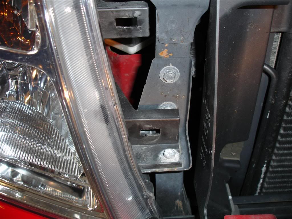

Next there are four square retaining clips in the face of the grill, two on the left, two on the right, next to the headlights.
This is what they look like with the grill removed:
They are slotted (screw driver required here) and need to be turned 45 degrees to slip back through the grill. I did one side at a time pulling out gently on the top of the grill as I turned these clips to further release the grill. Don't pull too hard four more clips left at the bottom!

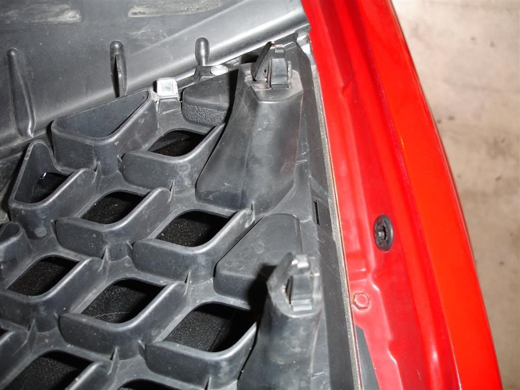

Next you need to reach down behind the grill and locate the four clips like this:
It's the object dead center in the above photo.
You simply pinch them, pushing up on the tab from underneath slightly and they'll pop right out.

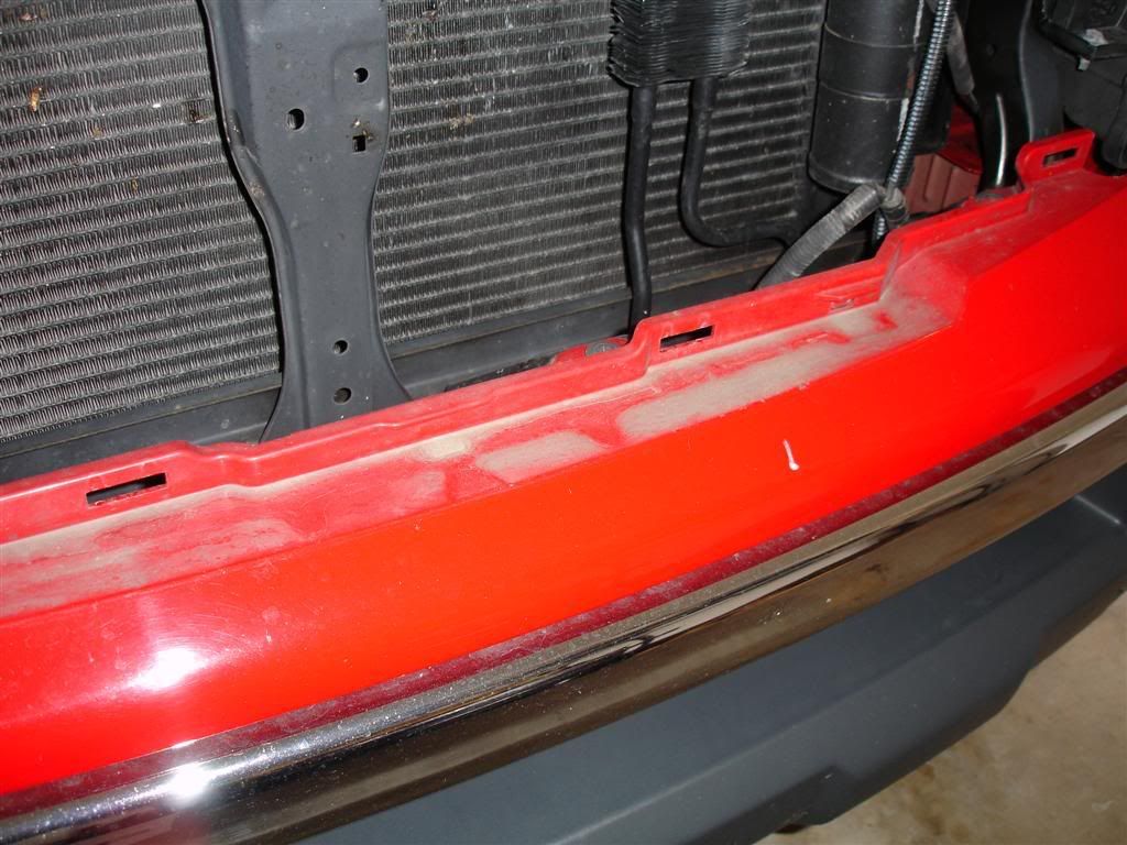

Here's the top portion of the bumper (grill removed) showing what the slots look like that the last four clips snap into:
Congratulations, you can now remove the grill.

The four square clips (picture 3 above) need to be removed from the sheet metal on the front of the truck and snapped into the back of the grill.
Front of truck showing square clips removed:
The square clips snapped back into the rear of the grill:
They will only snap back into the grill one way, so don't worry you really can't mess that up.
