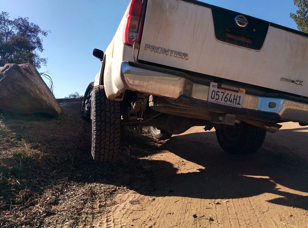

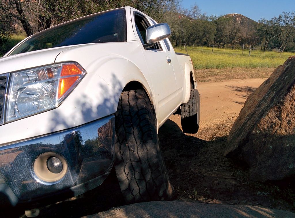

Wreckdriver got me thinking about how much flex I could get, so.....
It would seem that I could benefit from longer rear shocks, the stuff tire side is not bottomed yet the other side the shock is the limiting factor.
This is literally at the end of my driveway:D

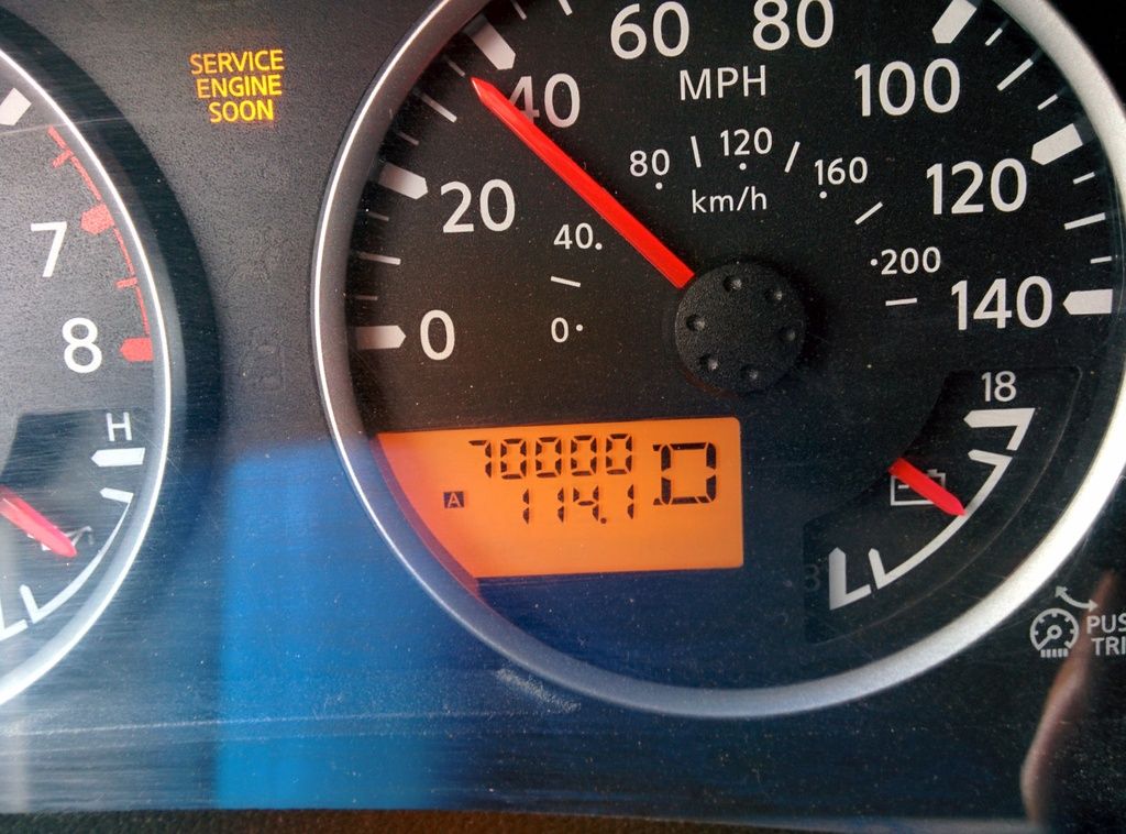

Rolled 70,000 thus morning... Which means I'm driving the truck WAY to much. 10000 miles in a little under 5 months. The new school I'm at added a good bit of distance to my daily commute.
As for truck updates, not too much to report. This Friday I'll be ordering the $50 evap valve to fix the check engine light and maybe get to cleaning the interior a bit. Just been super busy with work and school, so the truck has just been a workhorse for me.
