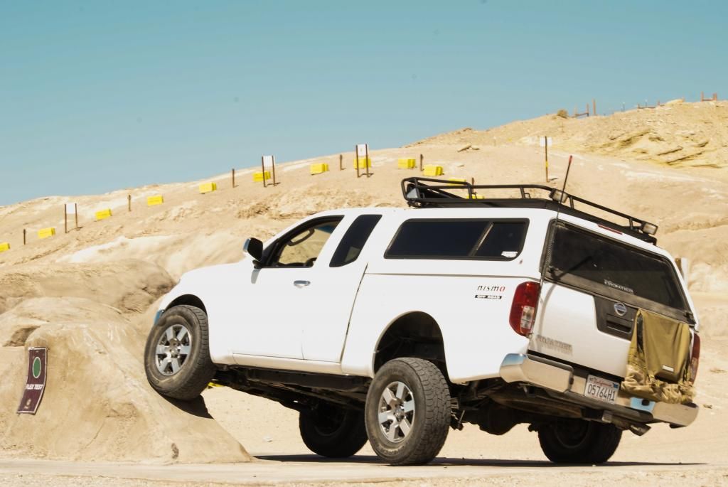

The goal of this truck is to do it all, camping, wheeling, and daily duties. None of which can significantly impact the others usage therefore I tired to take the middle ground on all tasks. This has turned out to be a great truck and does everything I ask of it, of course I keep asking for more in each category:D So it will never be "done" so to speak, think of Zeno's paradox;)
This is the sequel build of my truck as my last was totaled in a rear end collision(http://www.clubfrontier.org/forums/f103/glamisdude72000s-build-thread-76827/). So far this truck has been a substantial upgrade to the last one, having gained half the amount of miles, 2 model years newer, and 4x4 with a locker. This is the story of its progress, enjoy:D

On the way home from the Dealership in Vegas (Stock):
After first Lift and Tires: just ext travel
After T Swap:
Lights:
Electrical:
Under Hood:
Under Bed:
Mods:
Wheeling!:
