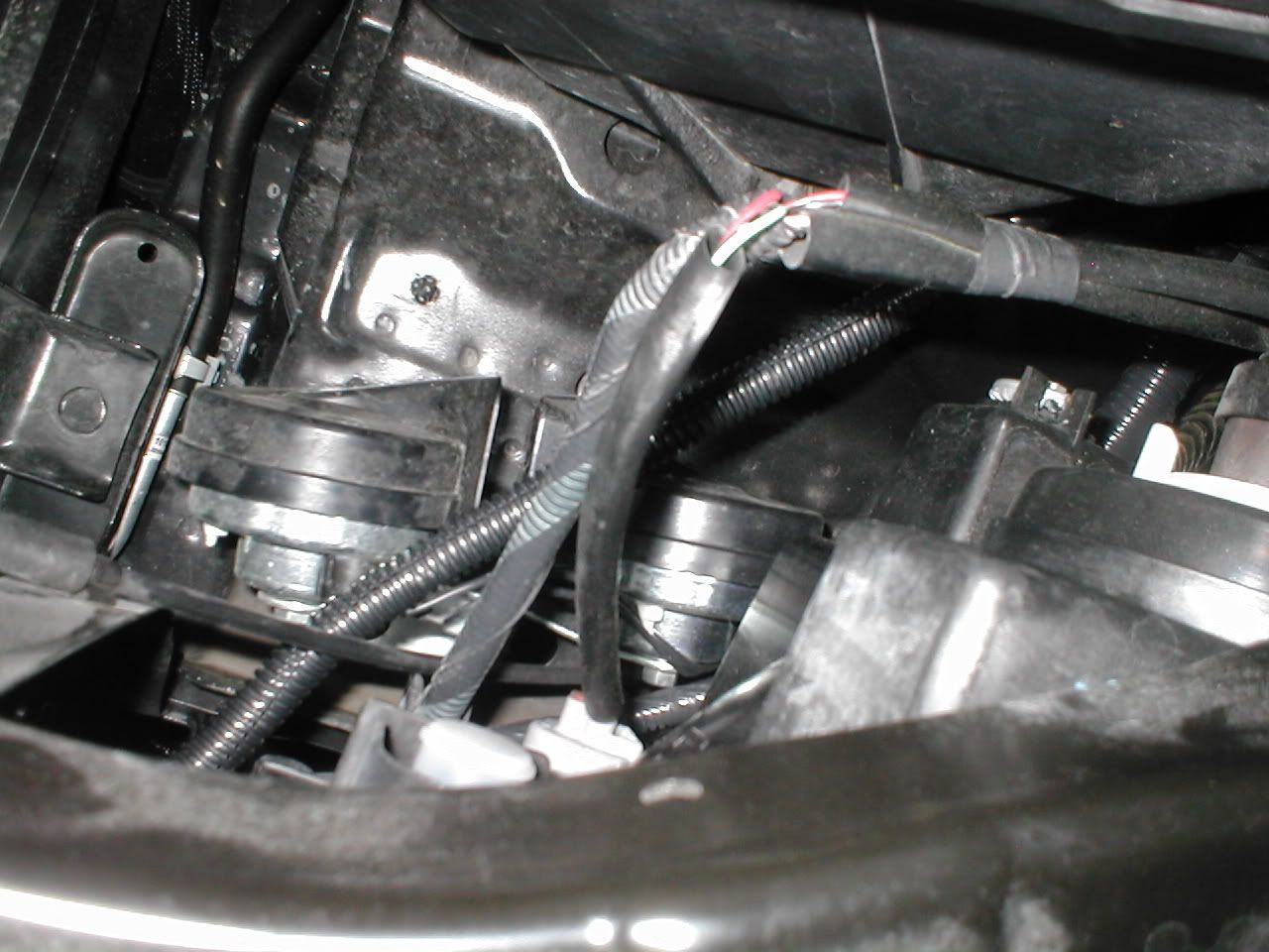

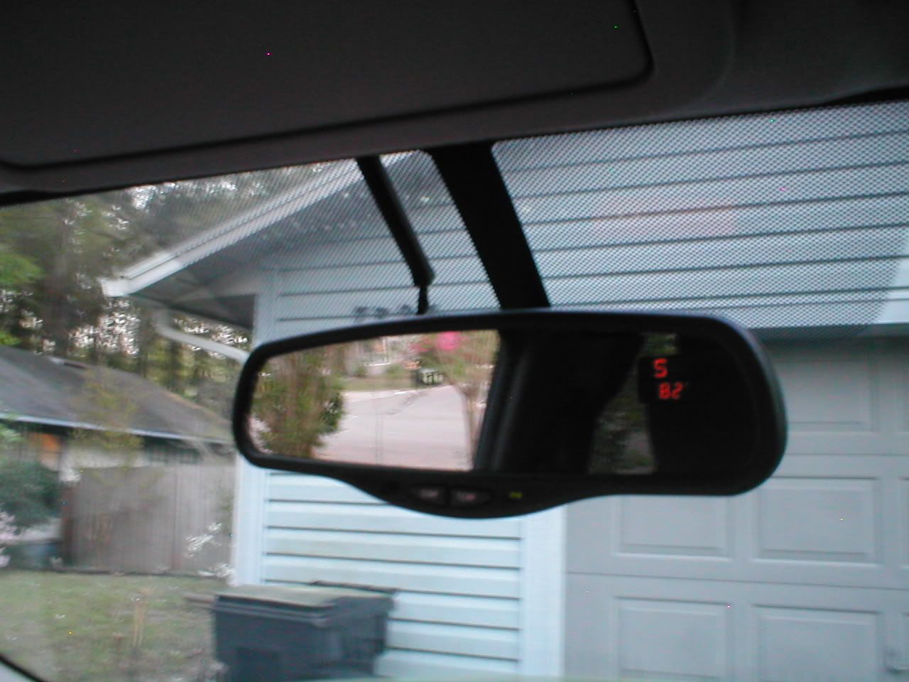

I just installed the GNTX-177 mirror purchased on ebay with the amber color temp/compass. Install took roughly 4 hours but I could do a second mirror in half that time now that I know how to take the truck apart. Great mod so far. I'm sorry I didn't take a single picture while the truck was apart. Install was very straightforward using posts from here and NewX. The amber really matches the dash well.

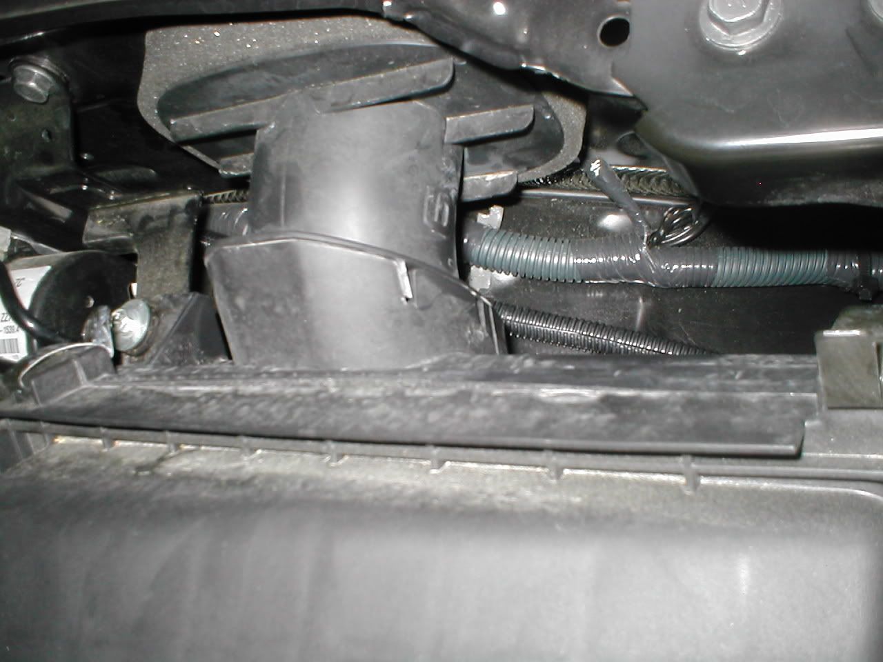

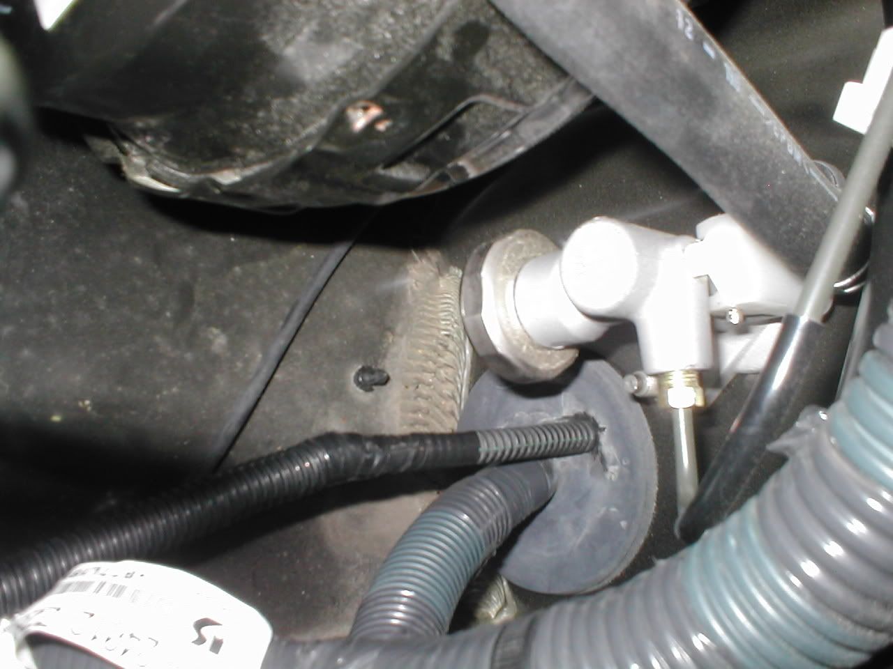

I used 18g wire but it appears the wiring on the mirror harness and the temp gauge pigtail are 20g. I just used standard crimping butt connectors and electrical tape. Wire loom in the engine bay and ziptied everything real good.
It is a pretty straight forward install. On mine the harness had 5 wires. 12v switched, ground, backup lamp feed (optional, turns off autodim when in reverse) and 2 wires for the temp sensor. I did not install the backup wire however I read another persons install where he wired it to a switch to manually disable the mirror.

Nice job on this DIY. One of the reasons I added the utility package to my 2011 SV is because of the outside temperature display. I use it all the time... but it's especially useful during winter to see if it's below freezing outside (in case I need to watch out for black ice). I don't know why Nissan didn't use the amber color though... mine is green

How accurate do you feel that your temp gauge is? Mine seems to read between 5 and 10 degrees too high however this morning it seemed correct. I emailed the seller and he says that is about right, the probes are not that accurate. Plus it reads hotter when you aren't moving.
254 Posts
I have this same Gentex unit but I had the dealer install it for $60. My temp seems to be off about 2 degrees at all times on the high side. Everything else works great though.

The mirror is in and it is perfect... you are right though, there is BARELY enough pigtail to get up under the headliner. It did make it, though, and the wire cover made for a completely clean install. After calibration, the compass is spot on and the temp sensor seems to be reading correctly as well. Good stuff!
