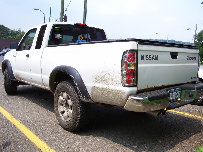

i bought the truck for 800 bills from a contractor (beat on it HARD) with the body in the condition shown in the below pic... it had a cracked block (he tried to use some gunk to fix it and made the problem worse, there was the said gunk everywhere, i even had to get all new cats because they were clogged from it)... it would start up and run tho (drove home 30 miles with a black plume of smoke), woot! hahah

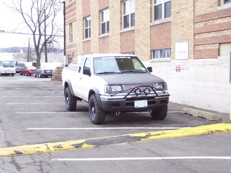

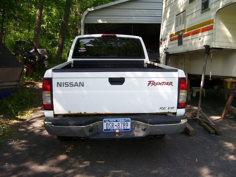

at first it was supposed to be a street truck.. sooooo the gayness known as euros went on :(

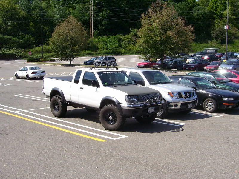

my focus changed when i went wheeling for the first time and got absolutly barried, soooo, new MTs (30s)/rims, t-bar crank, shackles, front light bar, and blacked out head/taillights went on

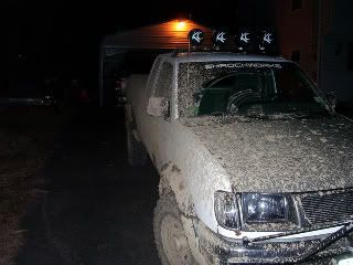

started wheeling more and with going to college, i night wheeled mostly, so light was more light was needed

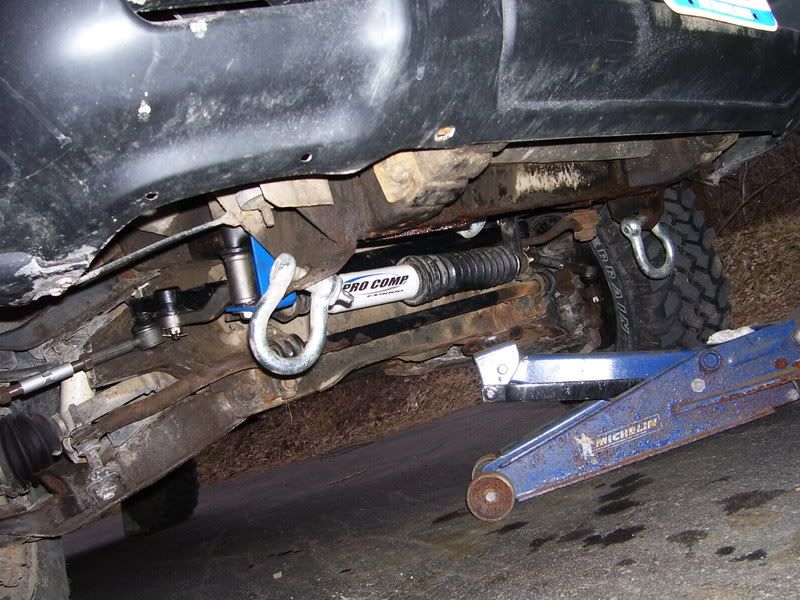

found out my steering sucked... so i replaced it haha... still wasnt enough, now im waiting to put houdini's old L&P on

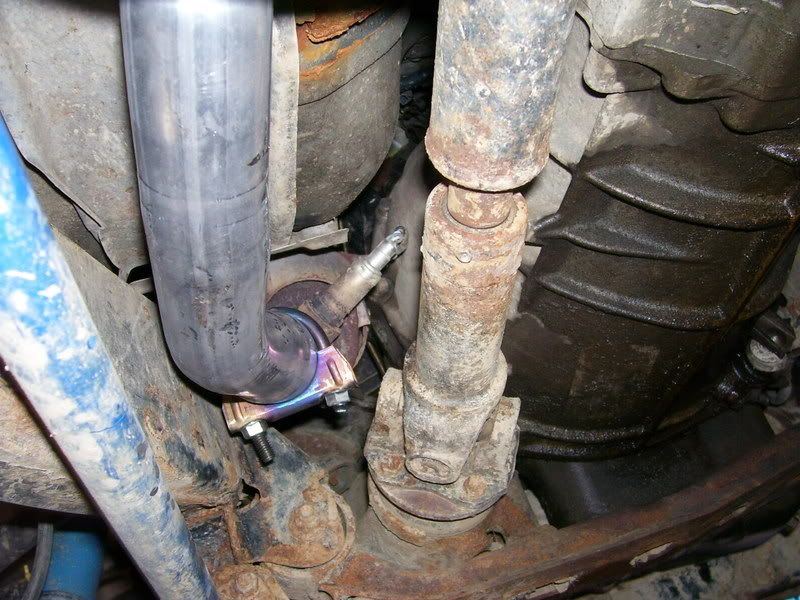

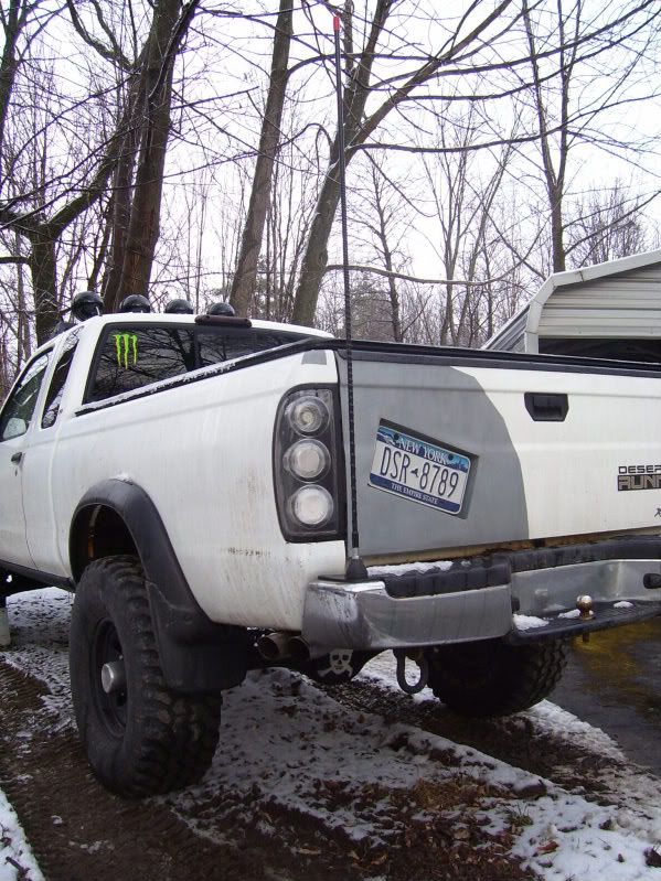

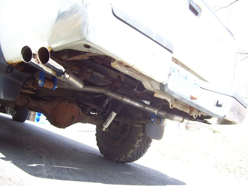

switched the exhaust again...

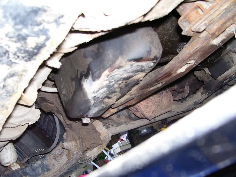

i then came down on my oil pan, so a call to shrock was made
ordered my lift cuz i was sick of how low i was, i also frenched my plate at this time... i still rocked the 30s hahah

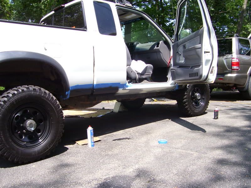

went all rust crazy and decided to get rid of it for good, i couldnt stand it... nothing POR 15 couldnt handle

cut out my secondary cats

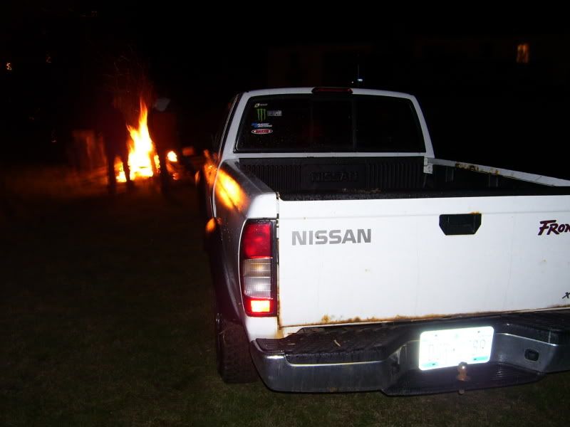

lastly added a CB

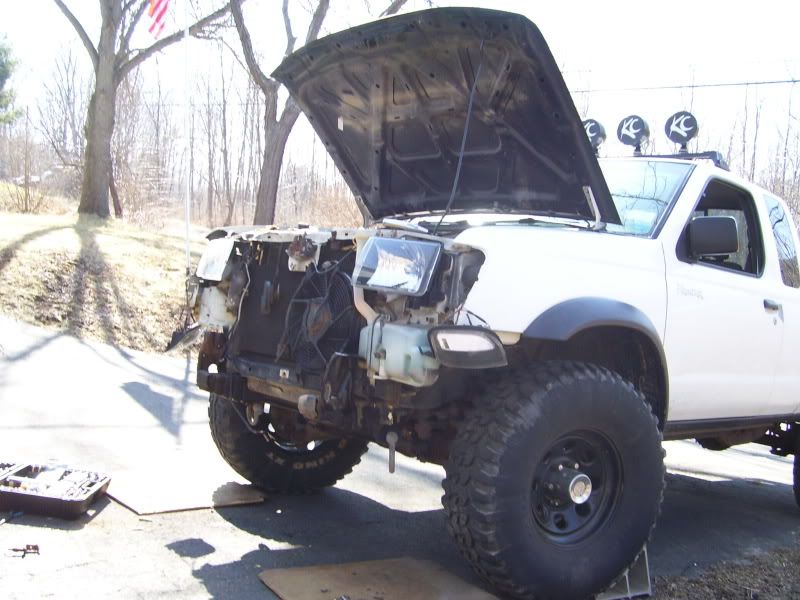

Xterraaaaaa front grilllllll swap
wooottt
and go rid of that stock piece O bumper

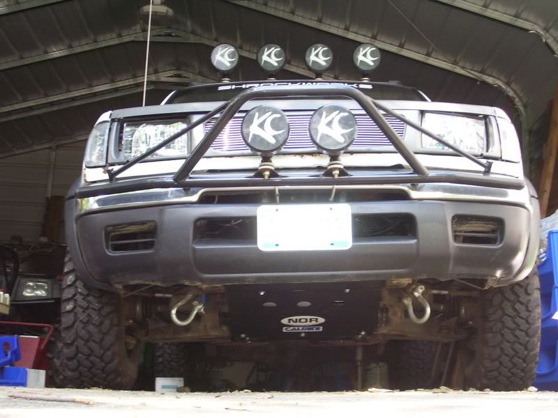

BLINGGGG for the new winch bumperrrrrr :D

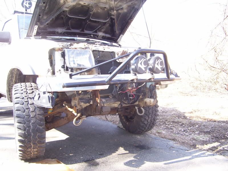

mock up, decided i NEED to box the frame and make it a bit longer
finally got a hold of a welder and spent all day today (sat) building these extensions and boxing the *** end of the frame plus built a tube cross member for more beef and a place to put rock lights (pics of that later once i get done cleaning it up)
started with the extension
boxed it and butt plated it so nothing moves.. plus drilled holes
i know, my welds arent the best, but there strong

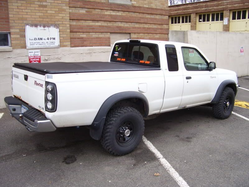

here are some pics with the softopper, everyone says all i need now is a machine gun turret mounted on the roof and ill be able to pass military qualification :D

What steering upgrades are those, I am not familiar with L&P. I just installed the The bilstien stabilizer kit and idler arm brace from AC, are they similar?
2,492 Posts
the L&P kit is a complete steering replacement, the centerlink now has spherical bearings in them, so no worries about busted BJs and they flex less which = no more bent TRAs
plus the idler and pitman arm are double shear which equals even less flex
876 Posts
Where did you pick those up? As far as I knew, the AC stuff was all that was made as far as strengthening up the steering for a 1st gen. I wonder how similar our trucks are, from those pics they look diff
2,492 Posts
Discussion Starter · #12 ·
unfortunately L&P went out of business, but their kits still float around, i bought mine from brian (houdini... guy with the big SASd red first gen)
SLR and total chaos also make complete kits
for a simple bomb proof steering, i suggest a new centerlink built by richard, it has spherical bearings and will out last the life of your truck
as for the trucks, we have the exact frame, the only different between ours is the front grill, hood, bumper and fenders... thats it

i also put on my OMF beadlocks with rockrings (it needs wheel spacers tho):

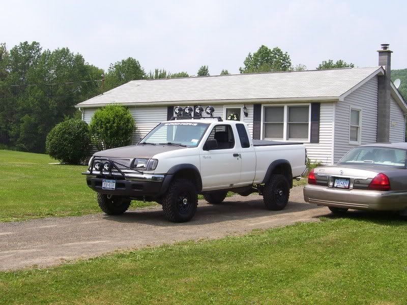

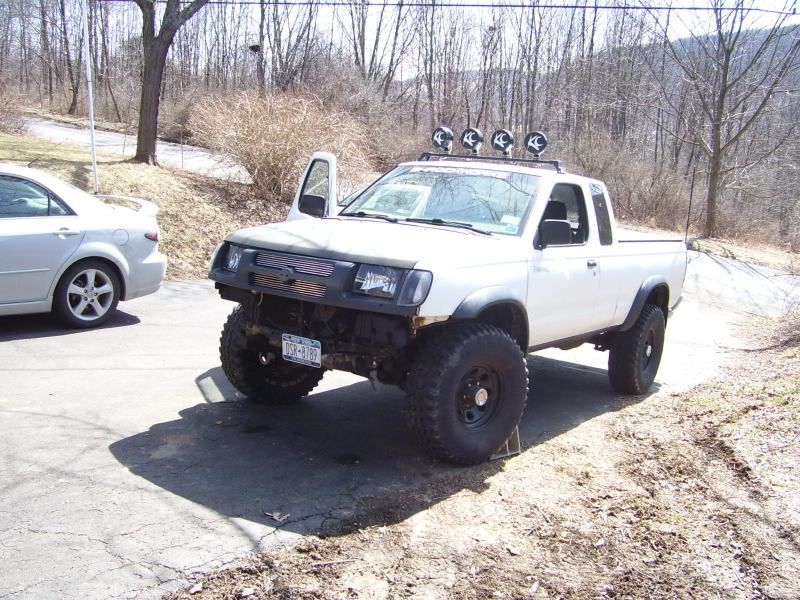

i also started working on a king cab roof rack. what i did was take a crew cab roof rack and cut it down to 39.5" to fit on my roof. it took me 3 tries to get the welds to stick (the coating nissan uses is incredibly durable) but once it did, i grinded it smooth all the way around (i wanted a stock look) and test fitted it
today, i finished smoothing it and decided to test fit it.. and heres the result:
its not attached, but once i get this damn headliner out, the holes will get drilled... it will also be painted black and ill have graveyard graphics make a king cab sticker to put on the side (like the stock crew cab sticker)

What do the rims need spacers? Is it due to the beadlocks or the tire?

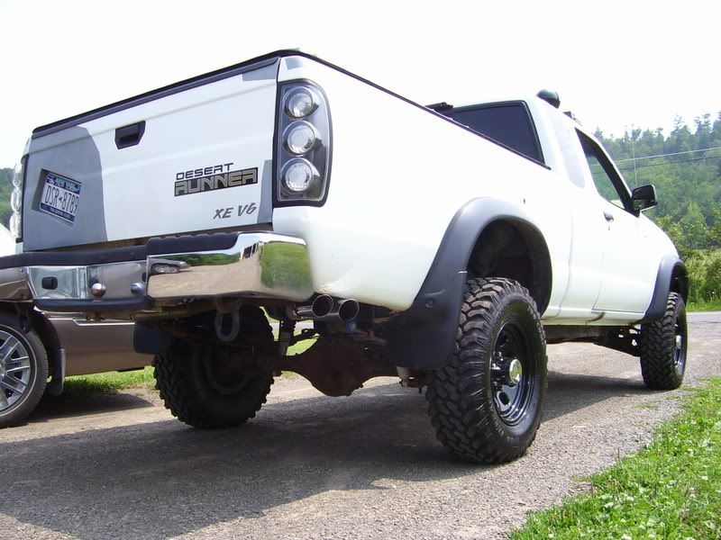

hertz got it correct, i rub the frame at full lock
plus it just looks plan weird to me on how far in the tires are

got the roof rack completely on and did some more hurc-in
and the money shot...
